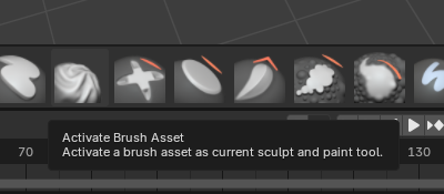

When checking the assets, I noticed that the tooltips are kind of not helpful currently. I’d like it if they would show the asset name and description.

Quick Feedback
  • No brush name on tooltip, most likely necessary for first users

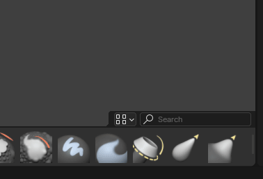

  1. First of all, bug when duplicating asset. It shows this, brush settings disappear and you get error in console
    After you manually select that newly created brush from asset shelf settings come back, but before it looks like this. And this is the error
  sub.active = (brush and brush.sculpt_tool != 'MASK')
TypeError: bpy_struct: item.attr = val: UILayout.active expected True/False or 0/1, not NoneType

tried, same result :frowning_with_open_mouth:
Same here, even with factory settings there’s no highlight on the active brush
Why isn’t the name on by default?
That was a decision made early on, I think based on feedback from @JulienKaspar. Memory is fuzzy but I think it’s because names become a lot less useful when dealing with 100s of brushes (a lot of them being just small variations) and the preview becomes more important instead.
It’s also useful to be able to display a lot of brushes, names take away space and the previews need to be quite big for the name to fit anyway. Generally the asset shelf (as opposed to the popup version) attempts to be a bit space saving, since it’s on screen permanently.
Lastly, it’s broken currently, but the brush asset shelf is supposed to have quick tooltips:
That might be a “best of both worlds” compromise.
