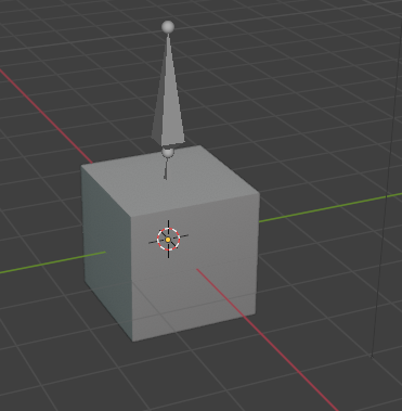

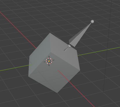

However, for another test, I noticed that root bones are not being posed correctly - I think the code is skipping poses for such bones. Grab the scene from #111931 - USD: Support armature and shape key export - blender - Blender Projects and export to FBX. It contains only a single posed bone. Then import using old and new:
old new
Relatedly, bones are imported as un-connected - each can move freely even if they have a parent. There’s a use_connect property that is somehow set on the old importer but not the new. I think it would use a heuristic and check to see if 2 bones overlap their respective head/tails and consider those that do overlap as “connected”. This problem also exists for USD which I haven’t worked through yet either.

Thanks! Good catches.
  • Will look into missing “is connected” flag for bones,
  • Will look into posing the root bone properly (I had skipped it since it was causing issues in some other test…)
