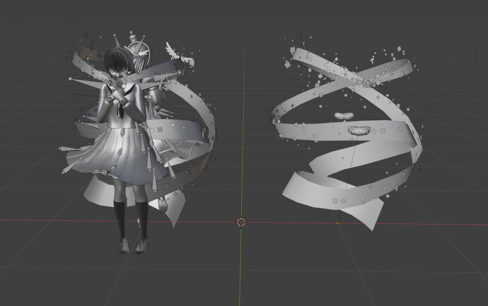

Found one regression case when checking the files in the ufbx CI dataset:
Python (left) vs ufbx (right), in blender-4.5.0-alpha+main.d791ea7cc2c6
As it is a part of the ufbx dataset, it should be quite validated to work well, and the example viewer seems to handle it.
I’ll try to scrape together a script to run through all the files in the dataset and rig some automated screenshot comparisons, but it might take a small while until I can get to it.
EDIT: I actually faintly remember this exact model from Godot. It’s possible that using UFBX_INHERIT_MODE_HANDLING_COMPENSATE_NO_FALLBACK would help in this case, though it will mess with the adjust_post_scale handling (and maybe make it unnecessary?).
