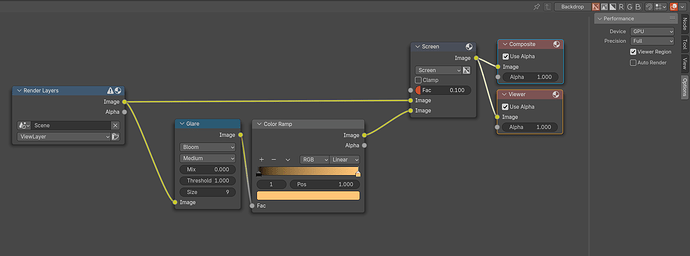

But here’s my Bloom setup to have it close to legacy:
The color ramp adjusts the bloom color and fade.

The current implementation of the Bloom node in compositor is indeed working as expected and can replicate the legacy Bloom, but it needs more setup around the node itself.
We acknowledge that this is less than ideal but will provide the equivalent node setup in the migration notes.
