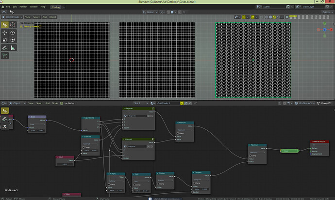

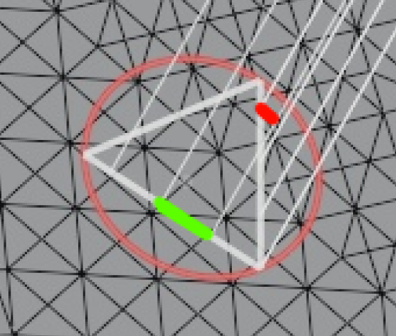

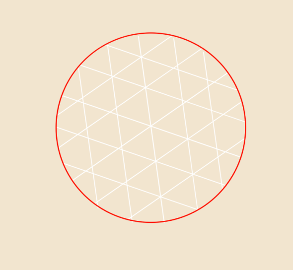

Current Dyntopo size visualization looks bad and low informative. I should guess what the size of tris, instead just see them
8860645
IMO easy shader that cross 3 sets of parallel lines is much more useful in this case
Same for Remesh resolution. Please use grid shader, and don`t hide vertical lines on small sizes.
Grid shaders.
Download here
I am not sure, what shader have best performance, because I don`t know perfomance of separate operations. But they are simple enough.
