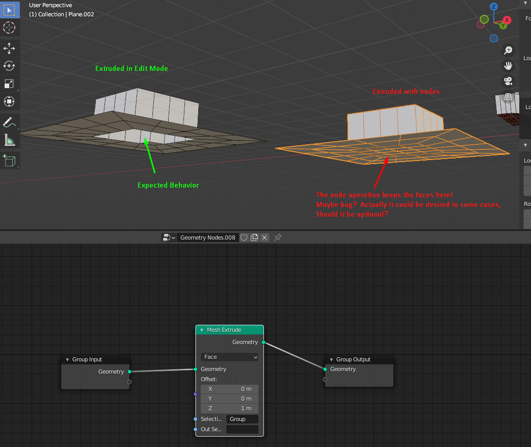

Mesh Extrude:
Here I tested solidify with painted weights to modulate the thickness, and then extruded the fill face, the extrude node seem to keep the original faces (the red ones), creating non manifold geometry, i think this is not expected right?
I tried again simply painting a vertex group on a plane and extruding faces, the node still keeps the original faces:
As mentioned in the picture notes, this behavior could be actually desired in some cases, maybe there could be an option checkbox (even a bool attribute) to output backfaces of the extrusion. But in my opinion, the default should be like the extrude operation in edit mode.

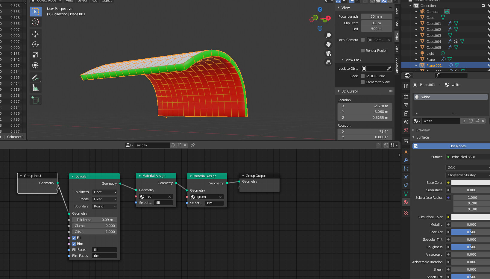

Solidify:

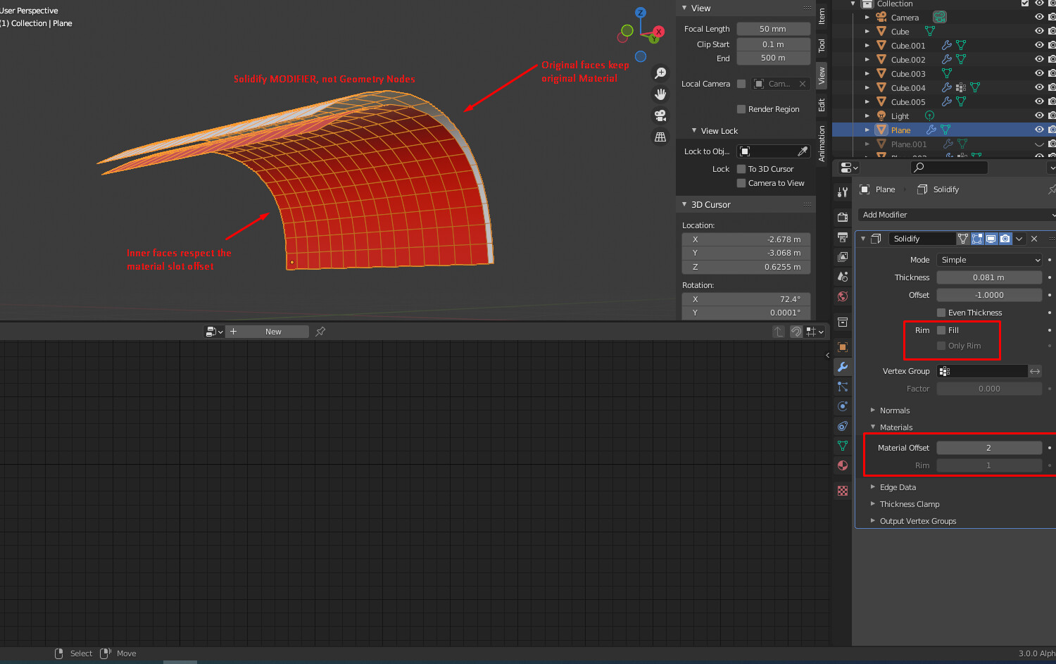

Im not sure, but I think that there is an inconsistency, with the terminology with the modifier version, Or at least a misleading/confusing use of the word “fill” IMHO, I may be wrong though.

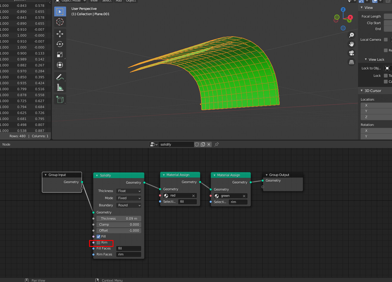

If I understand correctly, you are calling the new faces created by the node, “fill” and “rim”.
As you can see, the mesh has a white material originally, if output selections and assign materials accordingly, I can deduce that the newly created border (green) is the “rim” and the newly created inner surface is the “fill”, am I correct?
If I disable the “rim” output, to both the new shell and the original one is assigned the green material, like they are both marked as “fill”, I would expect the original shell to keep the white material (like with the solidify modifer version):

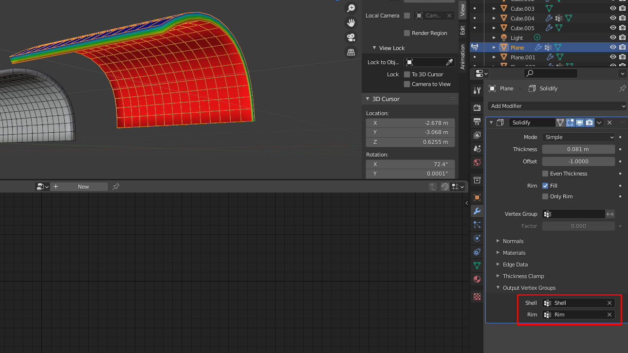

Geometry Nodes:

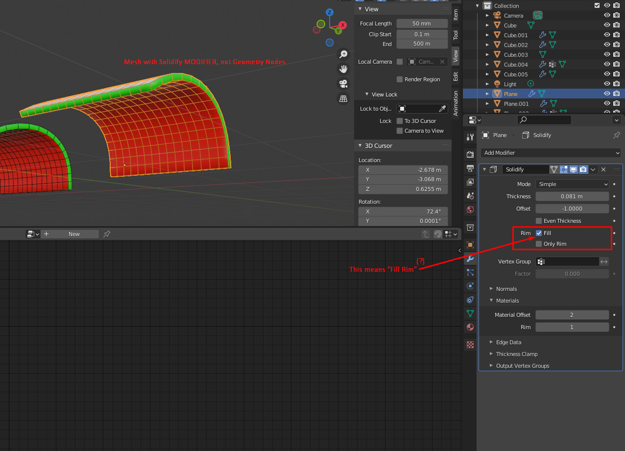

Modifier:
In the modifier there is a “fill” option, under the “rim” section that, as far as I understand means “fill rim”, and the option “only rim” outputs just the filled rim, but not the internal shell (in red).
Maybe , even the terminology in the modifier is not optimal, and confusing alone, at least it confused me, maybe a better naming for the node “fill” could be “new shell” or simply “shell” to avoid this confusion?Let me know what you think.
The modifier calls it “Shell” by the way:

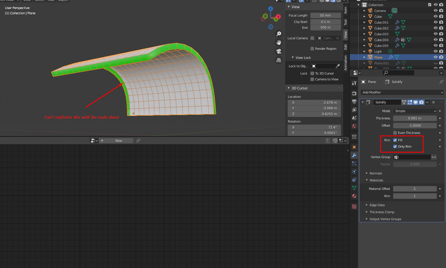

Another issue is that I cannot see a way of directly replicating the “Only Rim” behavior with nodes, having that would be really handy!

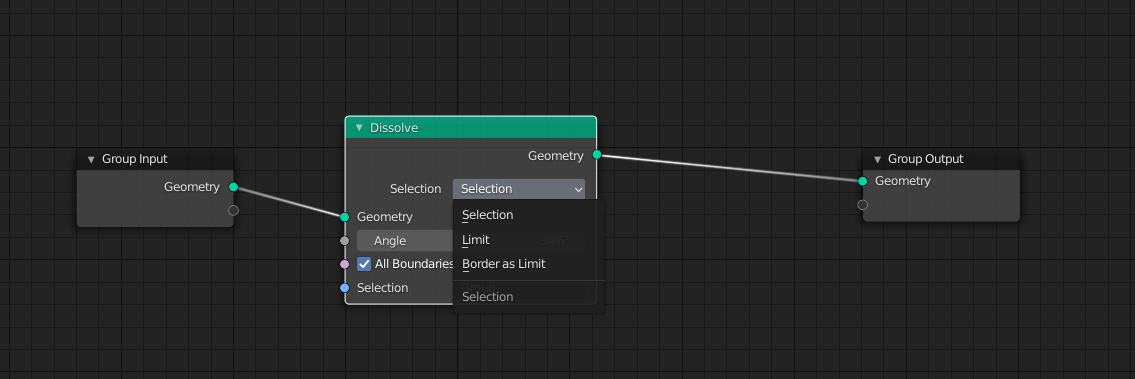

Dissolve:
Seems to work ok, my only concern here is still terminology, is the “limit” word here used in the same menu with two different meanings? “Edge as a Limit” here the limit is like, “the boundary used to dissolve the geometry around” it and “Limit” alone used as a verb like “limit to unselected”. Am I correct? If it is the case, i find it confusing. What other people her think about that?
Could a possible alternative be Selected, Not Selected and Selection Border as Limit? What are the conventions for similar features in other areas of blender?

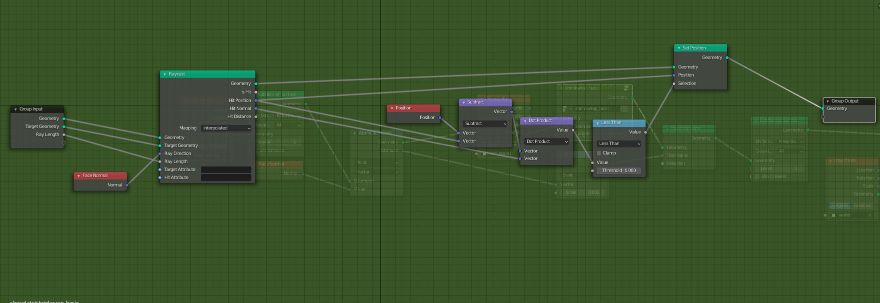

Hi Miro, Raycast and proximity you say? I wouldn´t know where to start…do you have a nodesetup for mimicing the Shrinkwrap that you can share/screenshot?
Here is a really basic implementation:
I managed to add more features to emulate the modifier, but I don’t have the file here on this PC right now, have a look at this:

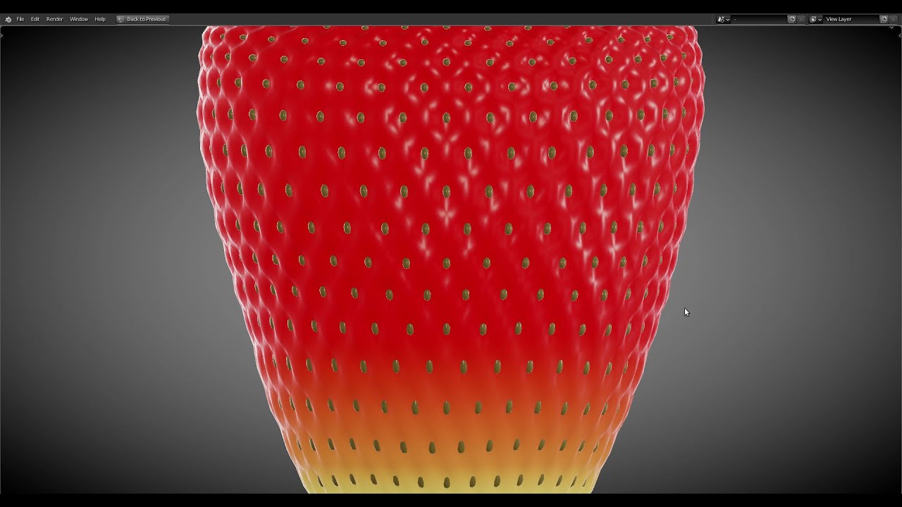

Hi, Fabian,
i’d like to ask for the status of the unsubdivide node. I need it for strawberries: (here an early version)
Thx for your reply.
