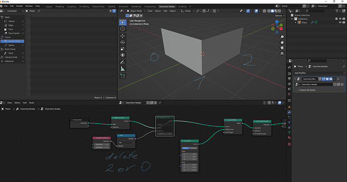

The problem seems to be that resample curve doesn’t use exact values, but rather divides the curve evenly using the closest value to the desired value. I’m not sure if this is intentional or a bug.
Yes I know this tnx and my question not for this I try resample part of curve but rebuilded all curve not only part
on screen you see how i deselect one point and try resample 0-1 or 1-2 part but its resample all curve.

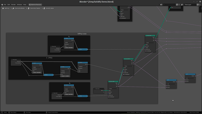

I’d like to share my solidify node with you. You can give a plane a 3rd dimension, or you can make a manifold object hollow, e.g. for 3D printing. Then just choose a negative thickness in the “Simple” mode.
The “Stiffing” mode divides the resulting extrusion of the solidify node into 3 layers, for sharper edges when used befor a Subdivision Surface node.
The lazy ones among you can grab the file here:
https://developer.blender.org/T95716
In Resample Curve node, selection input is for splines, not points. So if you have multiple splines in the curve, you can pick which splines to resample, but it will always resample whole spline.
