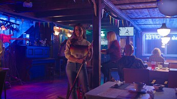

  • Second: Abney effect compensation.
Look at your blue lights in the back ground, don’t they look like purple?
It’s because of abney effect:
This means the user using your image formation algorithm will see the blue light looking a bit purple as it gets brighter. So now we need to purposefully shift the color a little bit to retain the blueness sensation. The blue light in light saber can be a good testing EXR. But here is another one:
Note abney effect is not just Blue, we need to shift all three primaries.
