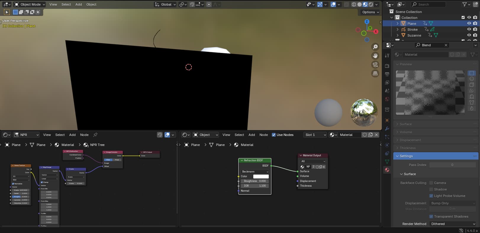

Wait, i have simple question for you. Does it work with grease pencil too? I just want to cerious it.

It works in the sense that you can have GP objects in the scene, just like with regular EEVEE or Cycles.
You can’t apply NPR materials on top of GP material since they’re not rendered by EEVEE.
Once EEVEE can render GP objects directly, then it should work just like any other object.

Okay, thank you for understanding but uhh why does it full of black plane?
Edit: Nvm, i fixed it. But yep, sadly it’s unsupported grease pencil :<

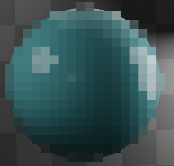

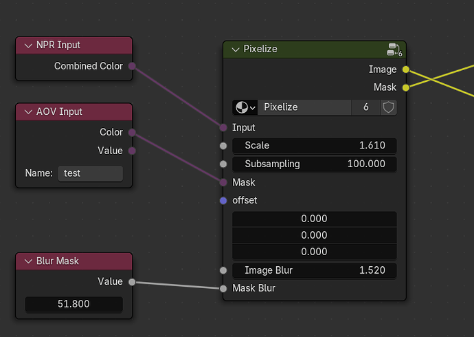

Alright folks I’ve fixed up my pixelized effect and made a handy little nodegroup, file is here!
I cleaned it up a lot based on my original nodes, its a lot less glitchy and has clean edges between pixels. if you check out the old version you’ll see quite a few nasty artifacts :sweat_smile:

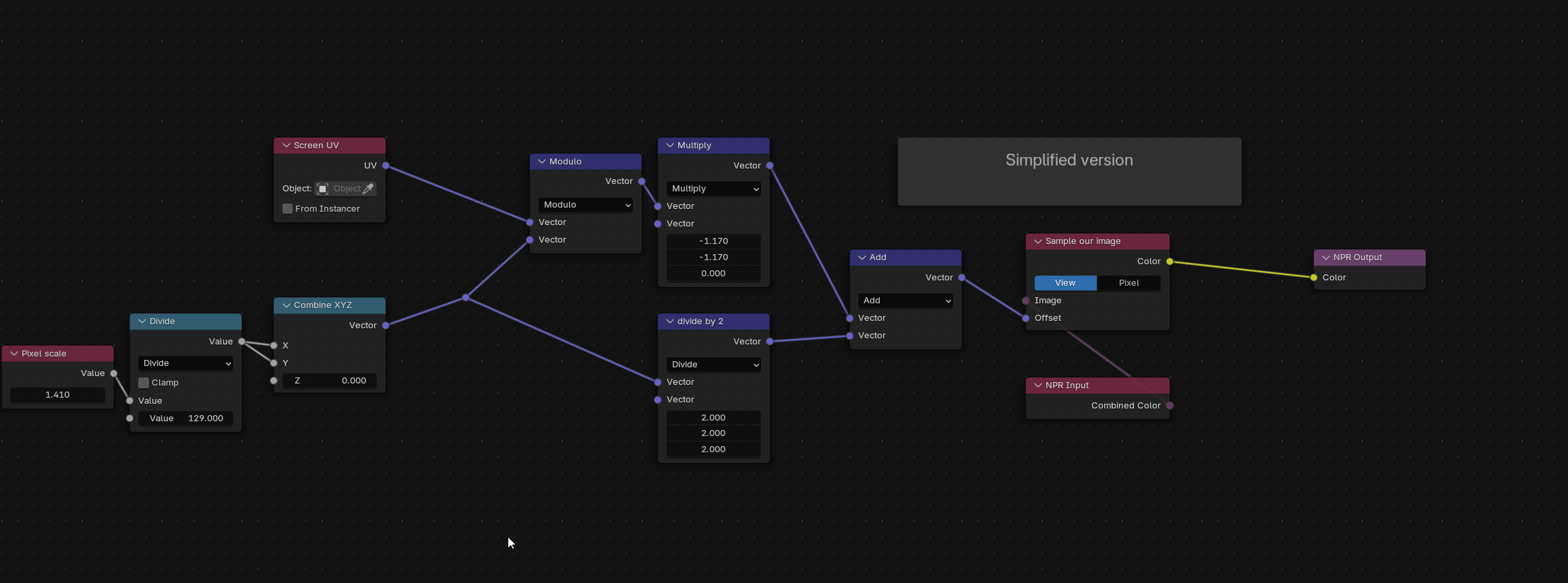

The blend file explains everything pretty well but i’ll share some of the nodes here as well :+1:

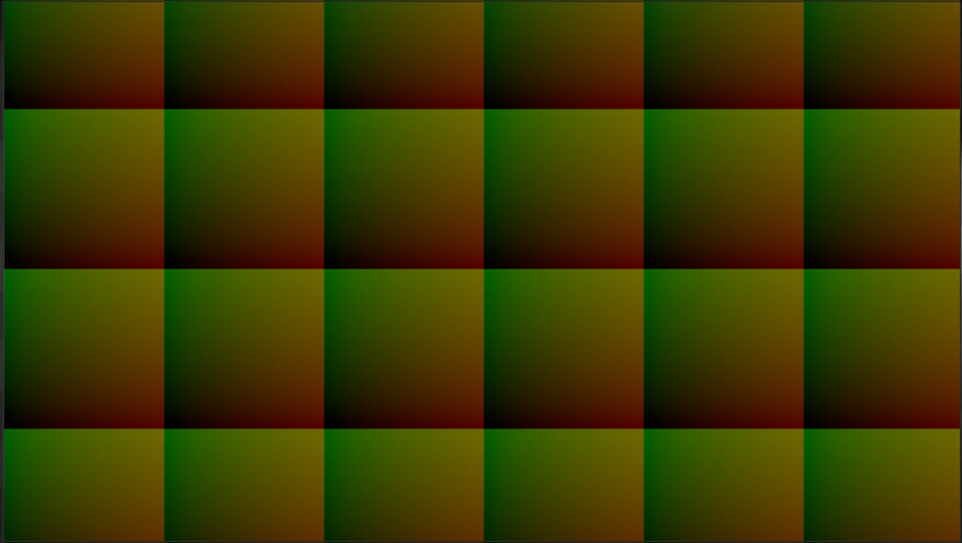

(It should be noted that I’m using a square image plane in front of the camera)

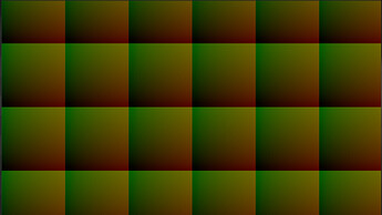

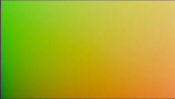

all this does is take the image plane attached to the camera’s UV and uses modulo to duplicate repeat it a specified number of times. we then feed this back into the image sample node and it creates a simple pixel effect.
however this is effectively zooming into a single location for every part of the ā€œmodulo gridā€, because of this it creates some pretty noisy artifacts.
So i beefed up the node group, added the ability to subsample to smooth out the colors of the result. This also happens to allows you to also blur the final image and mask if you would like :sunglasses:
Adding blur to the mask is really nice because it lets you add the pixel effect outside the mask a bit, which should fix issues like this where you can see the object behind the pixelization
The node group itself isn’t too complicated but it definitely adds some quality of life improvements.

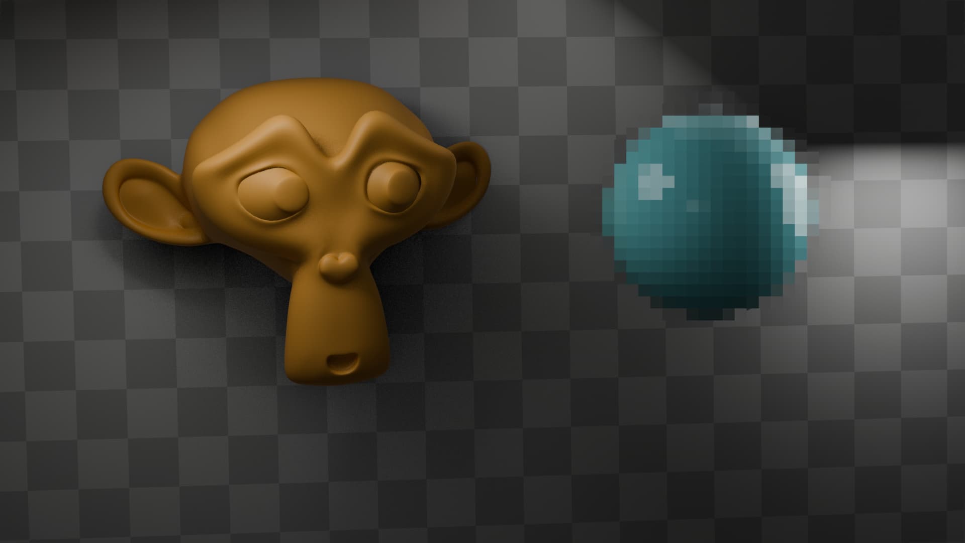

Tried the pixel effect on only the shadow pass for the background, pretty neat- I bet it would pair well with a cool stylized effect in the foreground.
Tried scaling the pixel effect based on distance from the camera, it creates a weird DOF effect.

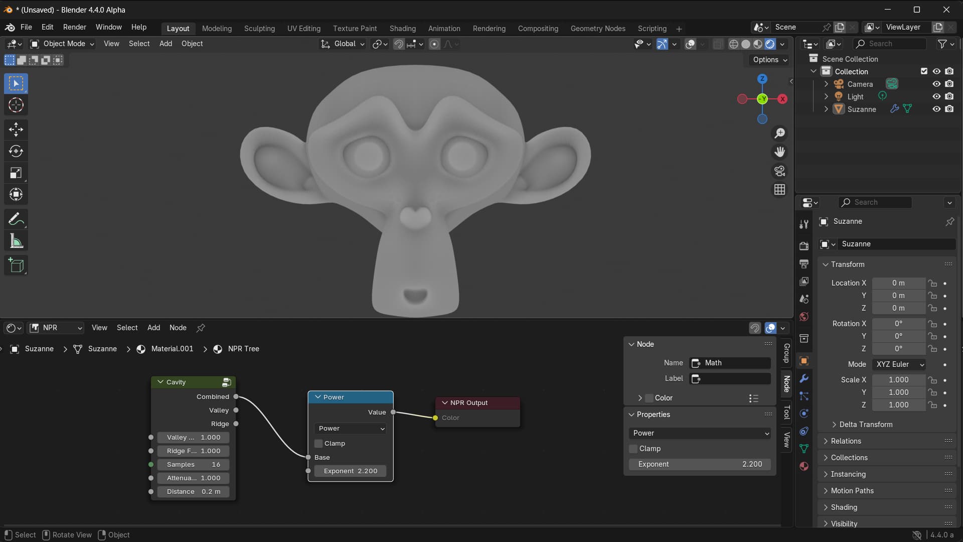

We now have a built-in Cavity node group asset thanks to @Vitalijs_Komasilovs !
It’s available on the latest build.

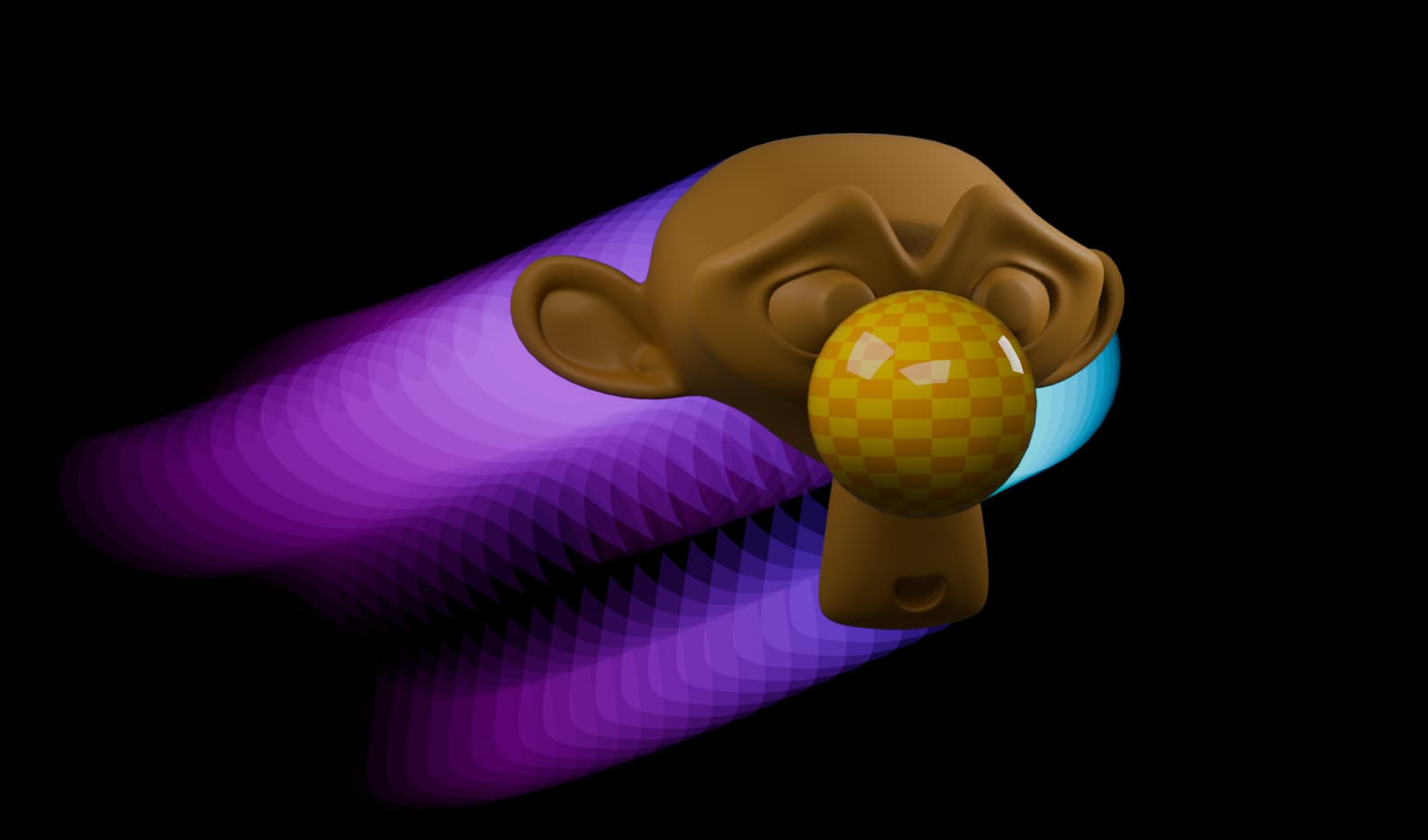

Alright folks I’ve been messing around with the trail effect and got some demo files to share!
Just like my previous posts these are pretty hacky demos, but I hope they can inspire some other effects and projects. More than anything I just wanted to see if I could find a synergy between Geo Nodes and NPR nodes.
Firstly, the oldest of the trail effect demos, this effect:
here’s the file
This file isn’t as clean as the other, and I’ve improved upon some things in the newer demos. I recommend looking through that file first as I explained things a little nicer in the nodes.

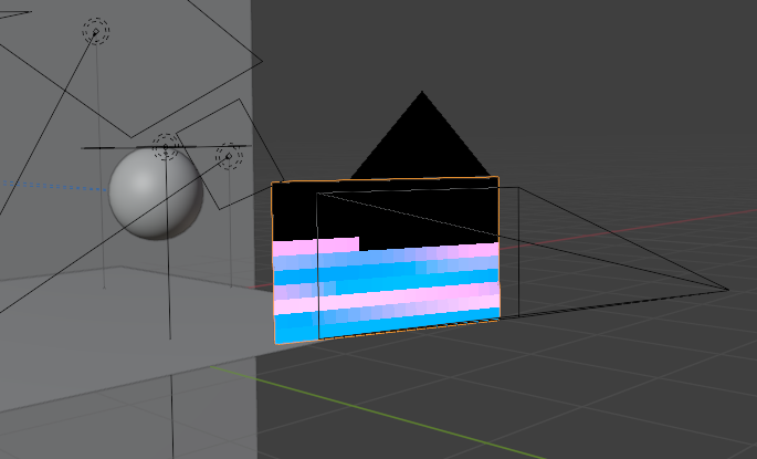

The main effect I wanted to achieve with this experiment was the ability to store and objects location and velocity over time. The cleanest way I could think to do that was to store it on the camera’s NPR plane.
(object’s location being stored every frame:)
(NPR plane parented to the camera:)

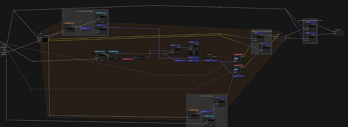

Every frame the NPR plane has a geometry nodes simulation that captures the location of the sphere and saves it to a different face on the (subdivided) plane.

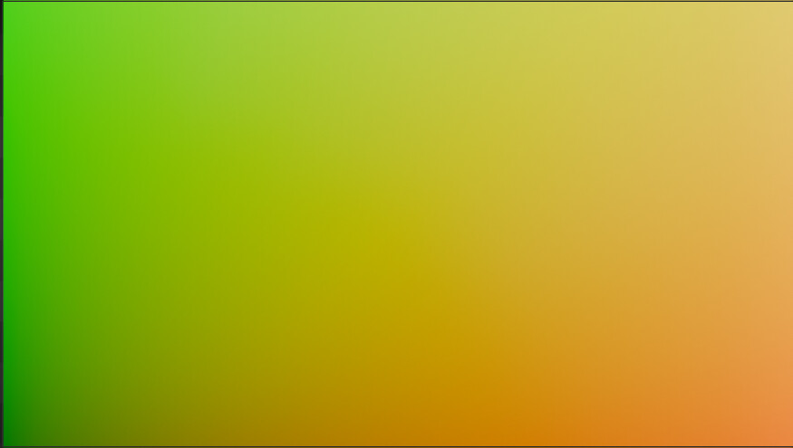

Once we have the position every frame, we can then use this effect:
which makes the selected object appear completely static on the screen. Once our object’s position is negated we can convert our stored position into screen space and add it back onto the static image. This results in… pretty much the default render lol. However, now that we have older locations from previous frames this lets us select where in time we want the ball to be! Add a little repeat zone and some logic through extra nodes and voila! We have our trail :+1: :sunglasses:
However there are some issues you can see with the version above along with some serious limitations. You aren’t able to apply motion blur to more than one object! There is also a hard limit on how long the animation is which is a bummer.
So I rewrote the nodes one last time and added the ability to add up to 11 objects on the screen to apply motion blur to as well as reusing faces on the NPR plane so you can make animations as long as you want. 11 objects can hold up to 20 frames each of data, but this can be altered by subdividing the NPR plane and editing the nodes throughout the file to match the new face count

I have two different methods for storing the mask per object, one is horrifying and I’ll let you discover that for yourself in the blend file lol, but it does fix this issue:
which is caused by overlapping objects removing a chunk of the trail.
I haven’t been super detailed in my explanation of how everything works in this post so I recommend downloading the demos and playing with the nodes yourself! I laid everything out as cleanly as I could.

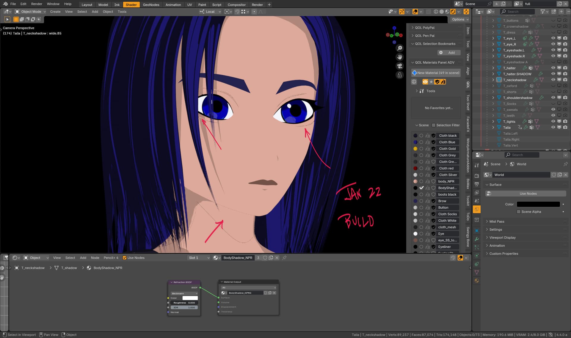

Default/World NPR setup
Since I am full-time software engineer, mostly using Blender on the weekends/spare time, I don’t really have the time to handcraft every asset for my renders. I mostly focus on my hero assets and use a couple of PBR asset packs for anything in the background.
A bilateral blur or kuwahara filter in the compositor usually do a good enough job at getting rid of the finer details, and combined with a bit of halftone shading and some paint over in PS usually result in decent results.
The problem is that I don’t really see a good way to emulate this workflow with the NPR branch. For every asset I append to the scene I would have to create a library overwrite, modify the material and add my npr nodegraph. Sure, it’s doable, but for large scenes with dozens or even hundreds of background assets this will become quite the chore.
An option to set a default/world NPR shader that is automatically applied to every material (even linked ones without library overwrites) that doesn’t already have its own NPR shader would vastly simplify that all and be very much appreciated.

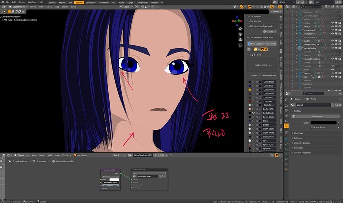

Option to create NPR Tree from the NPR workspace
This is something that threw me for quite a loop the first time I tried to use the NPR branch. In order to use the NPR nodes, you first need to switch to the material tab and add a ā€œNPR Treeā€ in the Material Output node. While I like how this allows you to repurpose the same npr nodegraph with a single click, it is somewhat unintuitive for new users who switch to the NPR workspace without setting things up in the Material workspace first.
All the add right-click options are just greyed out, with no explanation whatsoever. IMO there should be a centered text in the work area telling the user that the current material doesn’t have a NPR nodetree yet, ideally with a dropdown menu to either create a new node tree or select an existing one.
