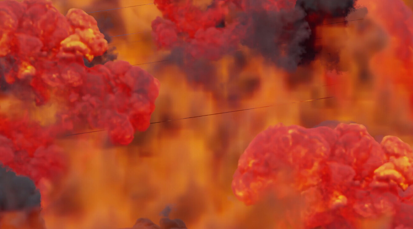

I get a lot of strange lines when I have single plane cards (with transparency) embedded inside a volume (see the images) with the current version of Cycles (I have not tried it with Cycles-X yet) I am wondering if this is a sampling issue that can be resolved in the new version.
I already filed a bug for this. The thing is if these (the cards and the volume) are rendered separately there are no lines, so this is clearly something about ray sampling in a mixed situation.
