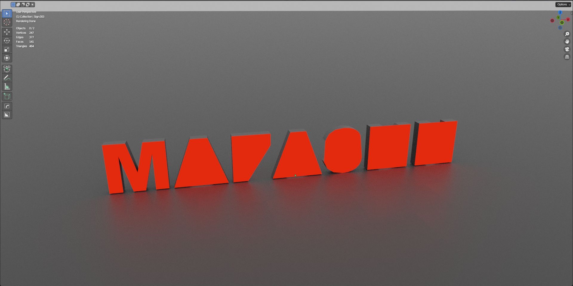

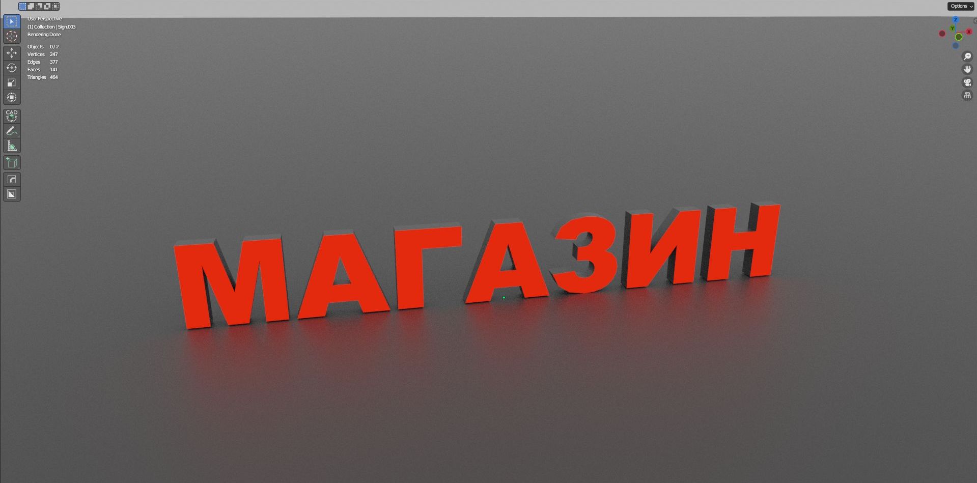

I know this is not the right place, but I can’t report this bug in any other way… Long story short: This is what one of my meshes looks in Blender 3.6 (3eff28a158ca) and before
Rendered mode / Cycles:
And this is what it looks like in Blender 3.6 (f54af343f175) and onward. The last version I checked was d3bab78d0540.
Yet, it looks absolutely normal in any other mode incl. Eevee. Triangulation helps, but as you understand, triangulating your meshes is not always an option. I was able to reproduce the bug using new custom geometry, but it was the other way around: it looked normal in the rendered mode, but corrupt in the edit mode.
