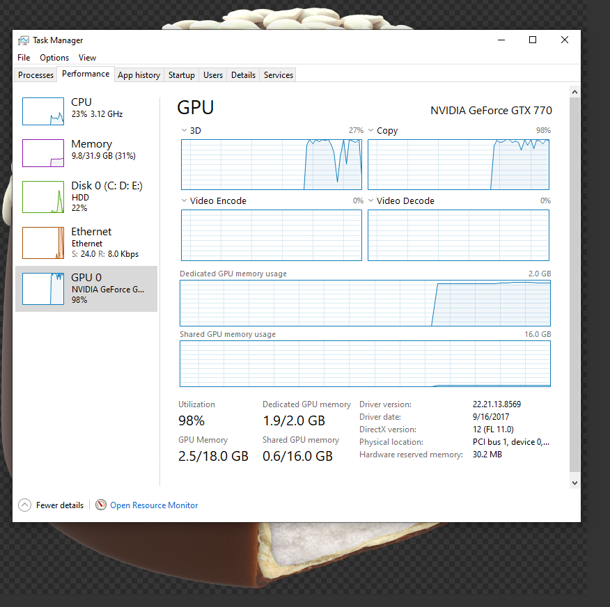

When i use graphic card for rendering especially when blender uses shared GPU memory , canceling render is too hard and take some minutes ! ( i use latest blender 3.1)
I can confirm that canceling a render can take ages.
I confirm too: I often open a new Blender instance and load up the temp autosave file
Yep. Canceling render is pain.

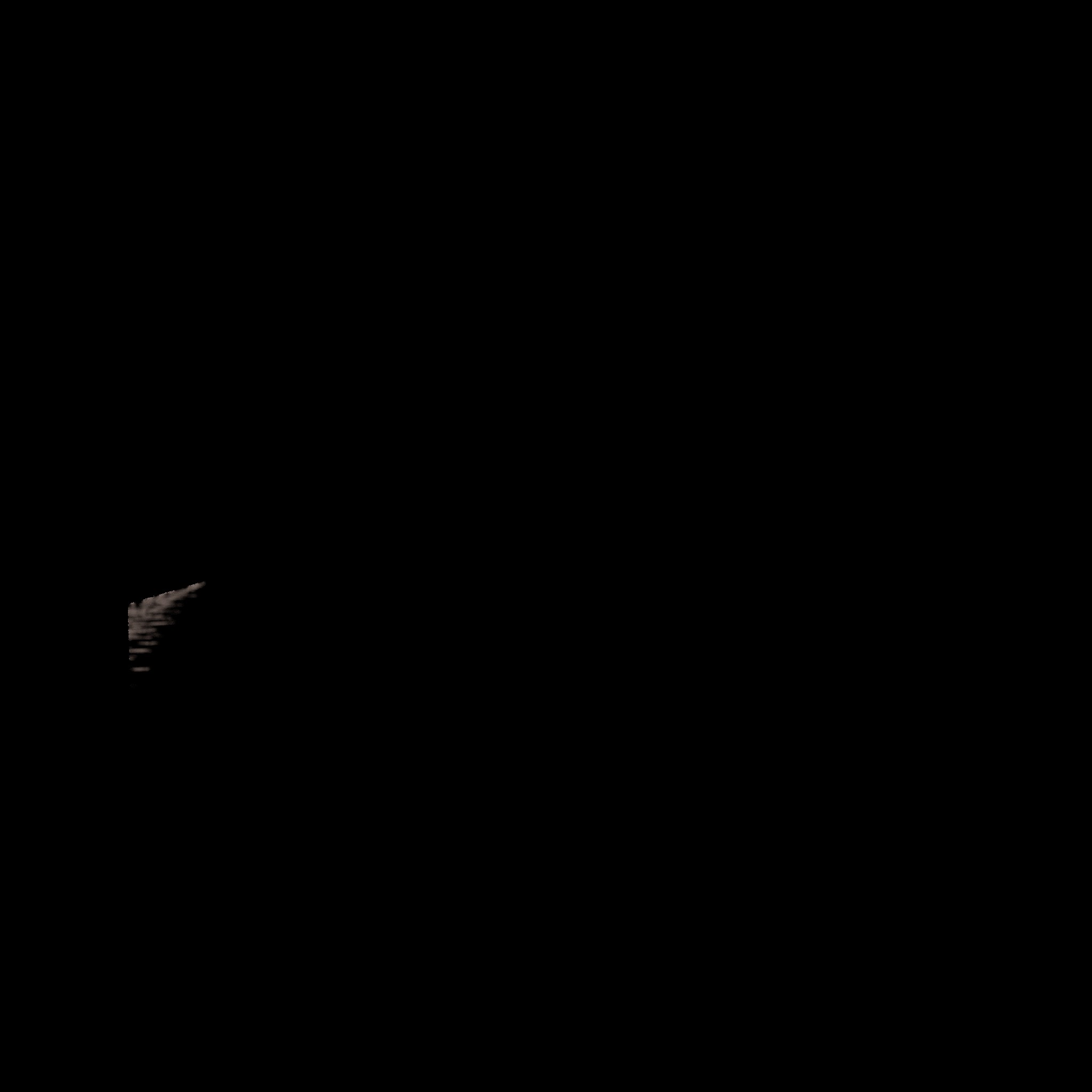

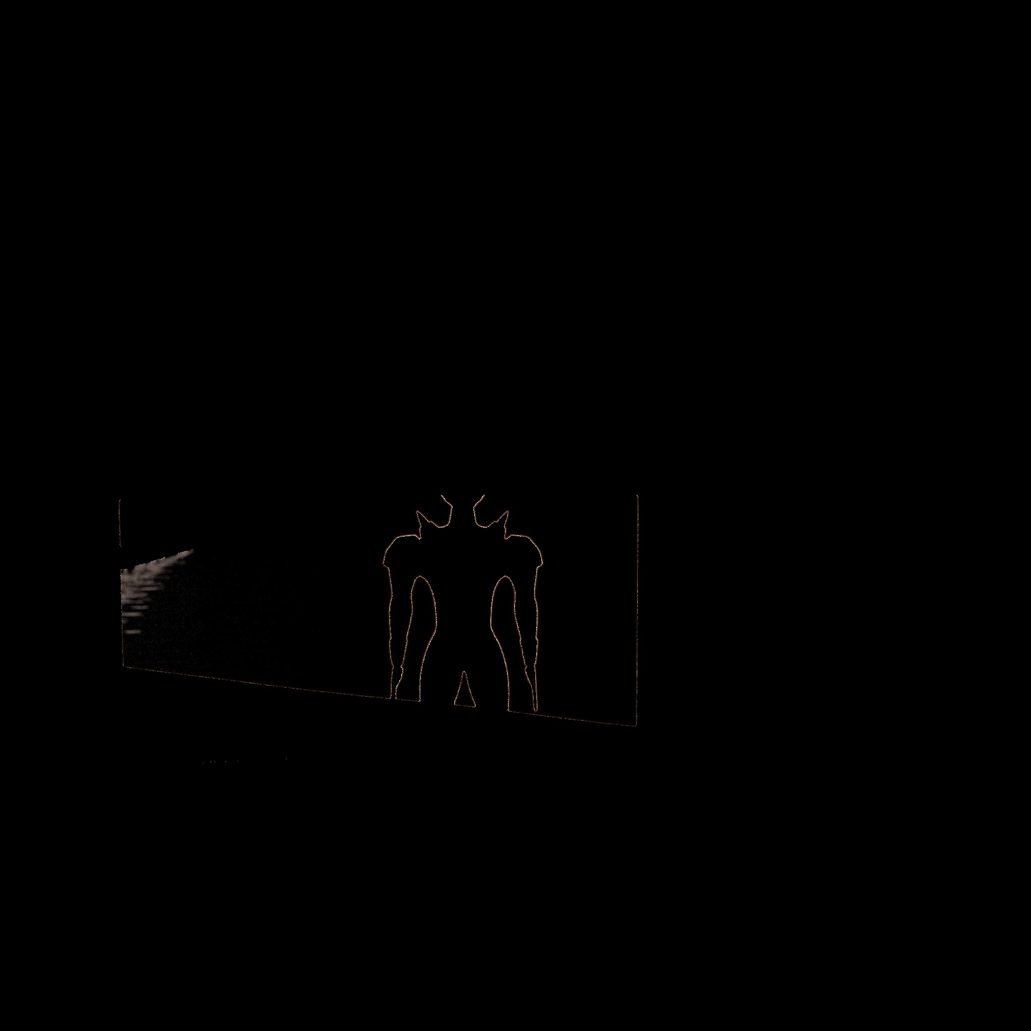

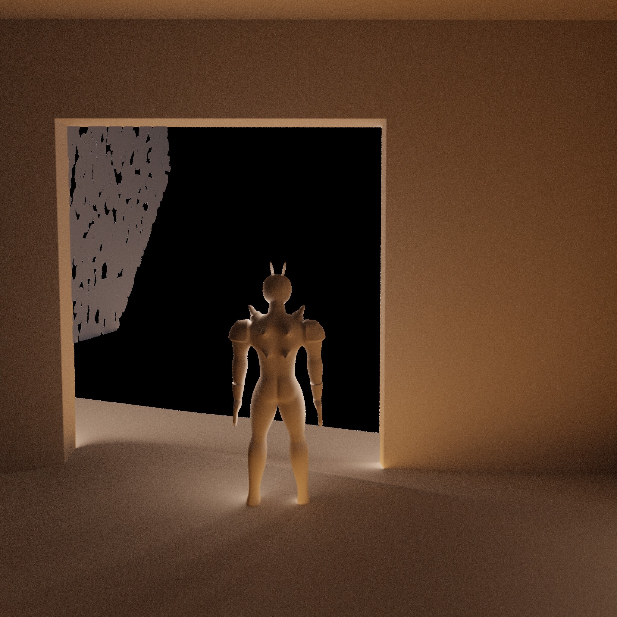

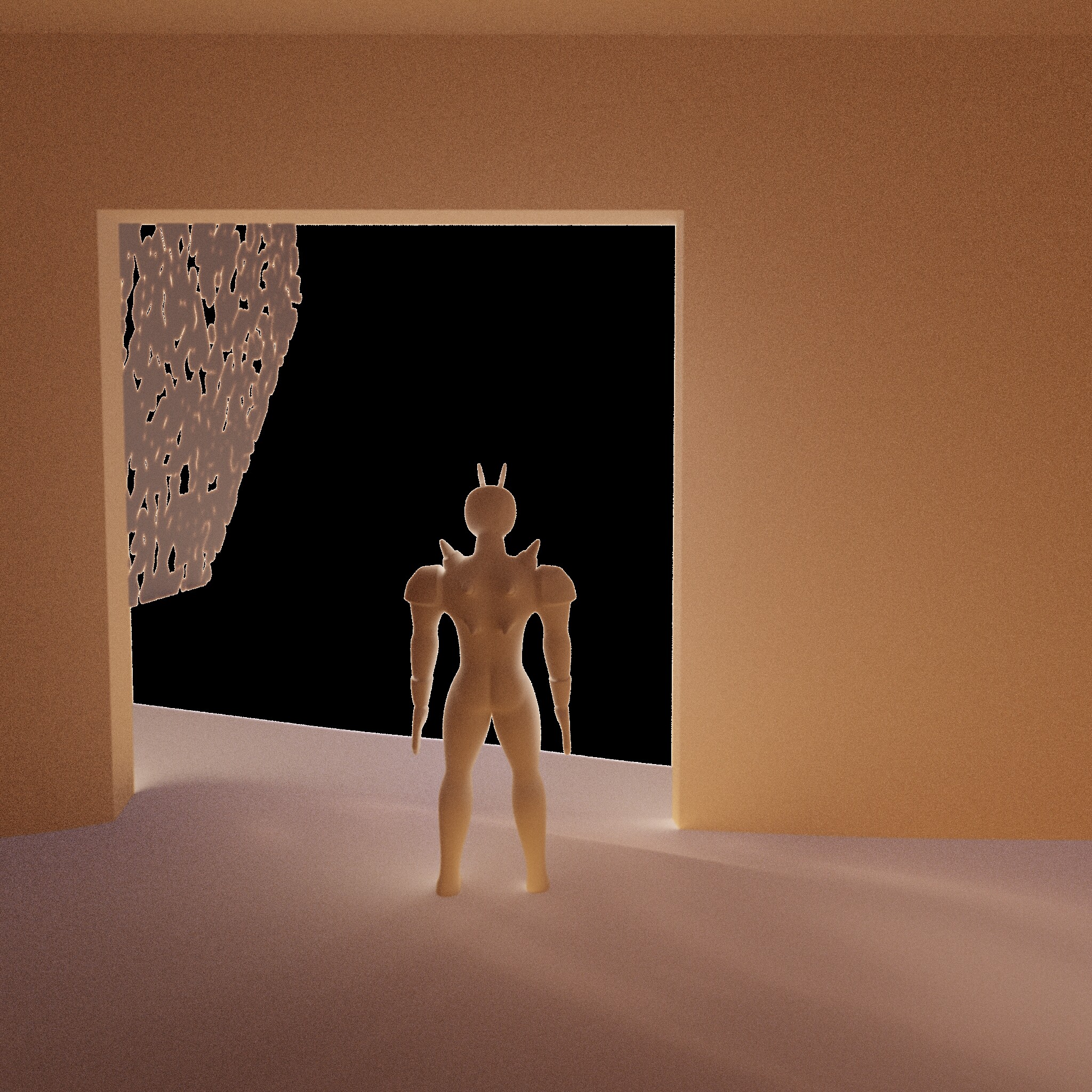

The new volumetrics in 3.0/31 is creating halo artifacts in the “Diffuse Indirect” and “Transmission Indirect” passes. Combining the passes in the compositor the halo artifacts shows, but is not in the “Combined” pass.
I have reported the issue a while back in Halo Artifacts. I considered it a regression, since 2.93 volumetrics does not create the halo artifacts.
The question I have is it a side effect of the new volumetrics implementation or a bug and is their any workarounds for this issue.
Here is the link to the test blender halo blend. Just enable or disable the volume cube. Notice halo outline artifact in person, window opening and sky holes plane.
Halo outline artifacts Blender 3.1 with volumetrics enable for the “Diffuse Indirect” pass:
No Halo outline artifacts Blender 3.1 with volumetrics disable for the “Diffuse Indirect” pass:
Halo outline artifacts Blender 3.1 with volumetrics enable for the “Transmission Indirect” pass:
No Halo outline artifacts Blender 3.1 with volumetrics disable for the “Transmission Indirect” pass:
