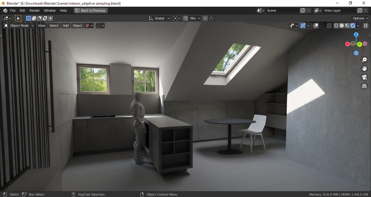

in my scene GPU + cpu takes almost twice as long compared to GPU. could someone check please, my pc is old. I use cyclesx 06-sep-21.it only happens with this scene

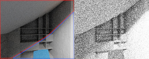

I leave min samples at 0. But even if I raise min samples to 256 or 512, noisier area stops refining as soon as it hits min samples and still gets less samples overall.
I think the issue is with how Cycles measures noise in general. Maybe it doesn’t take into account gamma and exposure of the final output? For example, if I save my image with gamma 1, then shadow area is almost black so it makes sense to stop sampling it early because the noise is not visible there anyway. Unfortunately in sRGB mode noise is still very obvious.
Just a theory though.
Is it possible to share your sample scene ? I’d like to do my own test with the same setup as yours.
Here you go Unique Download Link | WeTransfer
Although I doubt there’s something wrong with the scene. I’m noticing the same behaviour in other scenes.

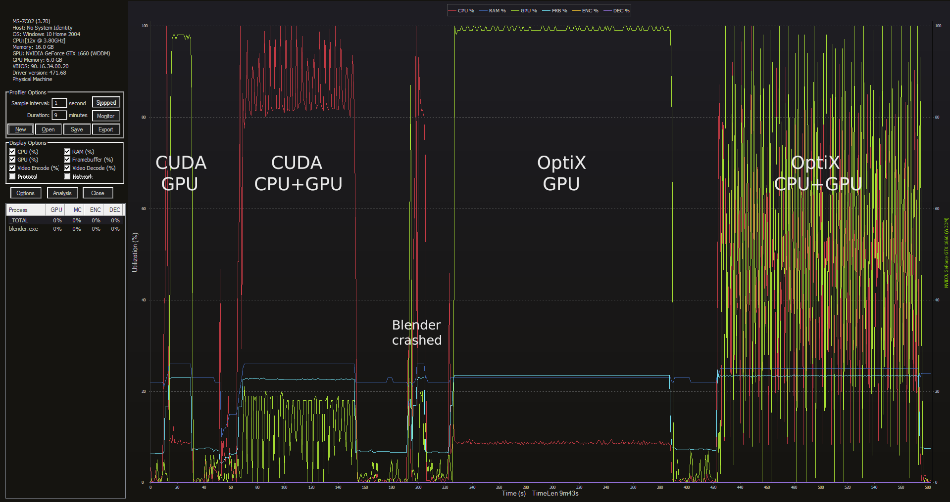

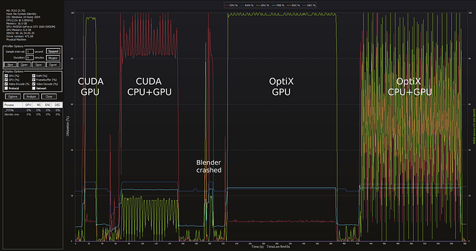

For me as well. It seems that cpu is holding back the gpu, judging by the gpu usage graph.
But I noticed something interesting with gpu only - optix takes 1m23s to render, meanwhile cuda takes only 15s ::
I tested your scene and performance was all over the place. It ranges from 21 second to 2 minutes and 30 seconds.
b.7bbe12b64f46
Profiler:
I also tested it with 3.0 Alpha Master branch (7beb4a0e0a49) and results were all over the place as well. Performance ranged from 43 seconds to 4 minutes and 30 seconds.
Profiler:
I don’t think Cycles takes that into account, there was a similar idea proposed a few days ago but I was against that.
I think it might be the light threshold? It samples less of the light below the threshold brighness and makes the darker part noiser:
I tend to turn it to 0 when its assumption regarding which part the image is darker fails. Maybe you can try this.
EDIT: Oh, just read Nequine’s post below, it looks like it’s completely unlreated to light theshold, it is simply the scene being hard to converge.

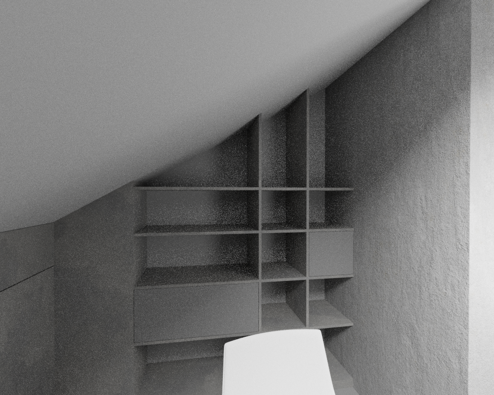

So, I’ve done some tests with your scene, and your scene is quite hard to converge for the renderer as your lighting is coming at 85% from the background shader with a strengh of 50. Adaptative don’t have much work to do here.
Your scene :
Without the background shader :

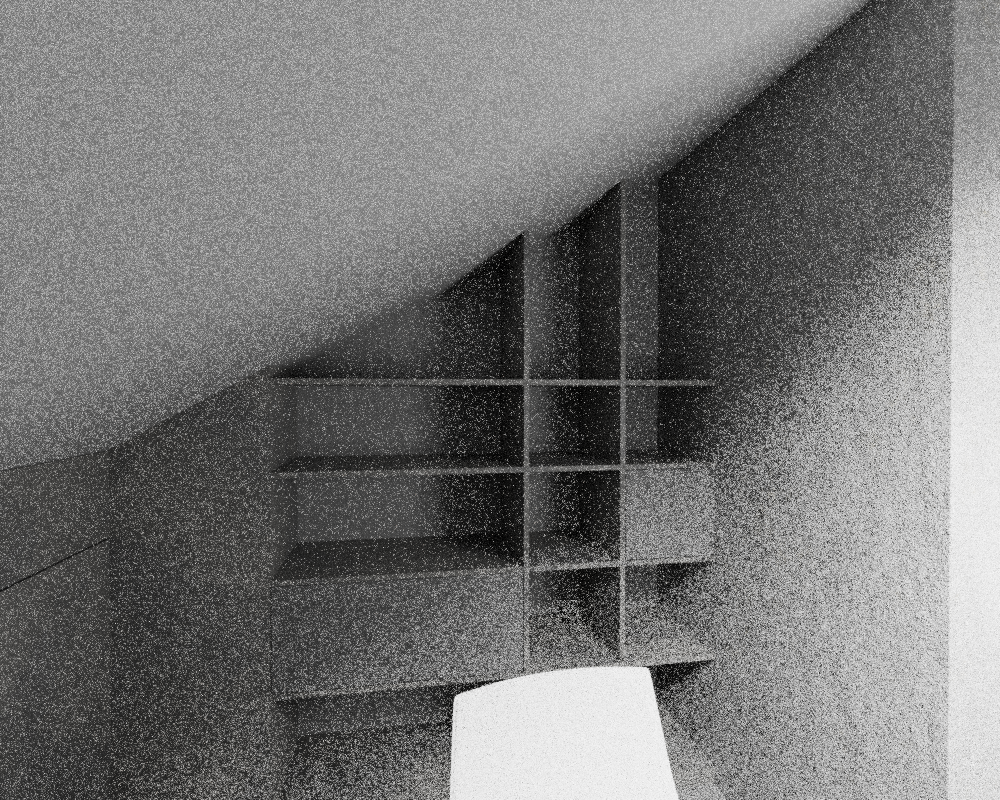

But in a second time I tried to match your lighting by using the area light used as a portal, to give an alternative solution. While better than the background shader, I was surprised how poorly the area light resolved at 128 min samples/1024 max sample, 0.05 noise threshold. I also forced min 2 bounce lights.
And with 512 min samples :

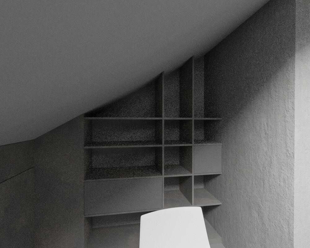

Here 2 other tests. 128-1024, 4 bounces, 0.005 light cut off and 1 quad light. ( sorry for the camera that doesn’t match ) :
Cycles -
Guerilla Render, a full progressive adaptive renderer that is, imo, a reference :
Guerilla held the render much longer ( 8min vs 12min ) but ended up with a more evenly distributed noise, which is more in line with what we can expect from the adaptative option.
In hope those little test can help.

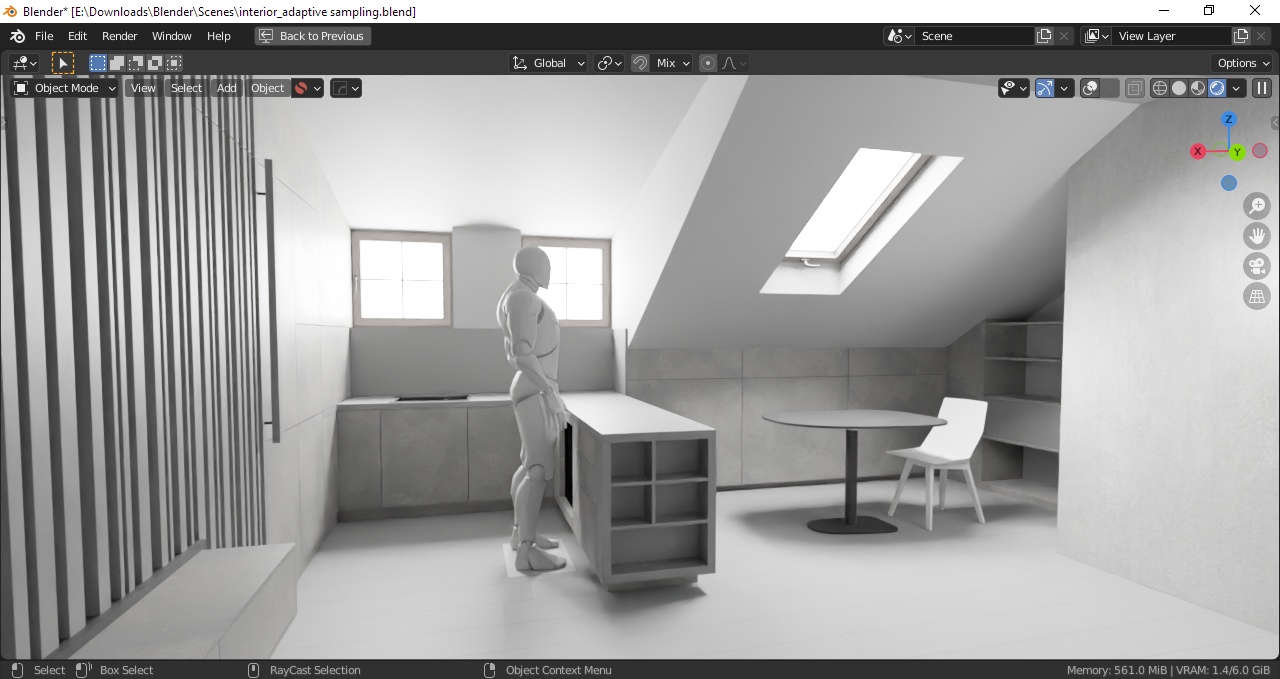

Yes, it’s a quite difficult scene, probably the worst case scenario for interior lighting, but that makes it a good test case. But can you elaborate on how you did that second example with area light used as a portal? Because I’ve already put portal lights in windows, and they help to reduce the noise a bit, although not as much as I expected.
But the issue here is not that the scene is hard to resolve. Without adaptive sampling even shadows clean up pretty well in a couple minutes. It’s not like rendering caustics, that you know are not gonna converge in a million years. The problem is that adaptive sampling work in a counter-productive manner here. For some reason red area hits noise threshold first, even though it’s still very noisy and stops sampling. Meanwhile blue area that is lit by direct light keeps getting more samples, even though it’s already pretty clean.
Surely, adaptive sampling should be doing the opposite and giving more samples to noisier parts of the image. My only explanation is that Cycles cannot properly detect noise in darker values right now for some reason.
Dunno about other people but my scene has correct scale, because it’s been modelled according to measurements of a real location. Keep in mind that this is a small attic apartment with a low ceiling which might throw off your sense of scale. For example kitchen top is at 85cm so that guy in your “correct” example would be about 130cm tall. :slight_smile:
Also difference in scale is too small anyway to cause any issues with accuracy. It would need to be off by orders of magnitude.

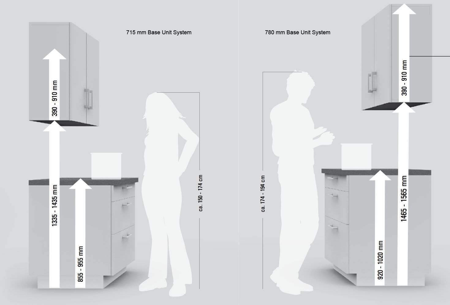

You are right, sorry if my comment offended you. That attic thing and kitchen top at 85cm is what messed with my sense of scale. Here is why:

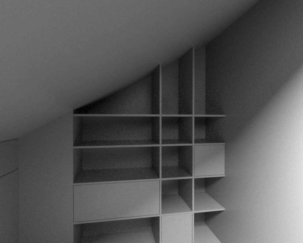

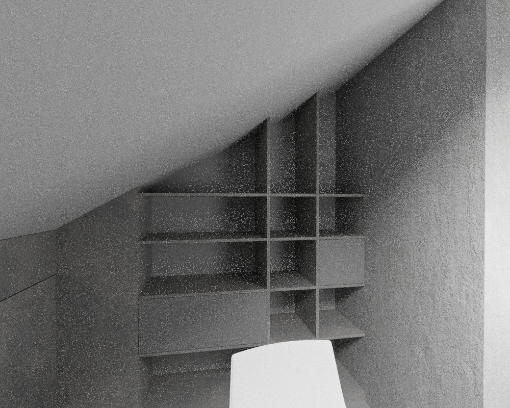

I did a quick test with your solution with my area light setup. Sadly it didn’t help at all.
build 66a5b1f6e50d, cpu, 512min samples 1024 max samples, 0.05 noise threshold, both around 8min rendertime
150W Area light, 1expo in film tab-
100W Area light, 2 expo in film tab-

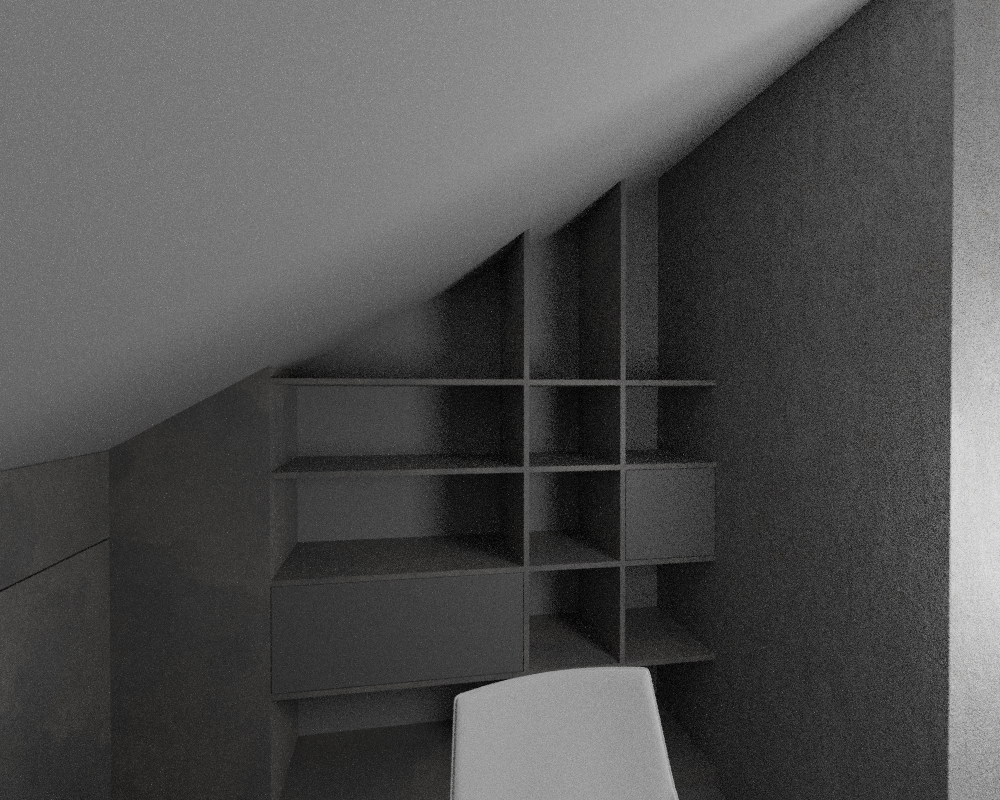

As a reference, I post again the Guerilla Render image. 128min/1024max samples
I have to add what we should NOT trying to fiddle around with the linear image outputed by the renderer. This should not be a valid all around fix for a sampling issue.
What you need to compare is Samplecount pass, you could do a test with 100W LAMP vs 1000W LAMP and compare the SAMPLECOUT? We are trying to have less samples in the bright area
The bright area are clearly not the problem here.
Why would I completely cheat something that should not be done anyway?
In your test scene I got lower render time ( so less samples used ) when your sky exposure was lower and film exposure higher. I gave a test with the same 1expo difference and it didn’t got any significant result. So doing it with a 1000w light should give me worst results than we already have.
Or maybe this film exposure is doing wrong from the start ?
