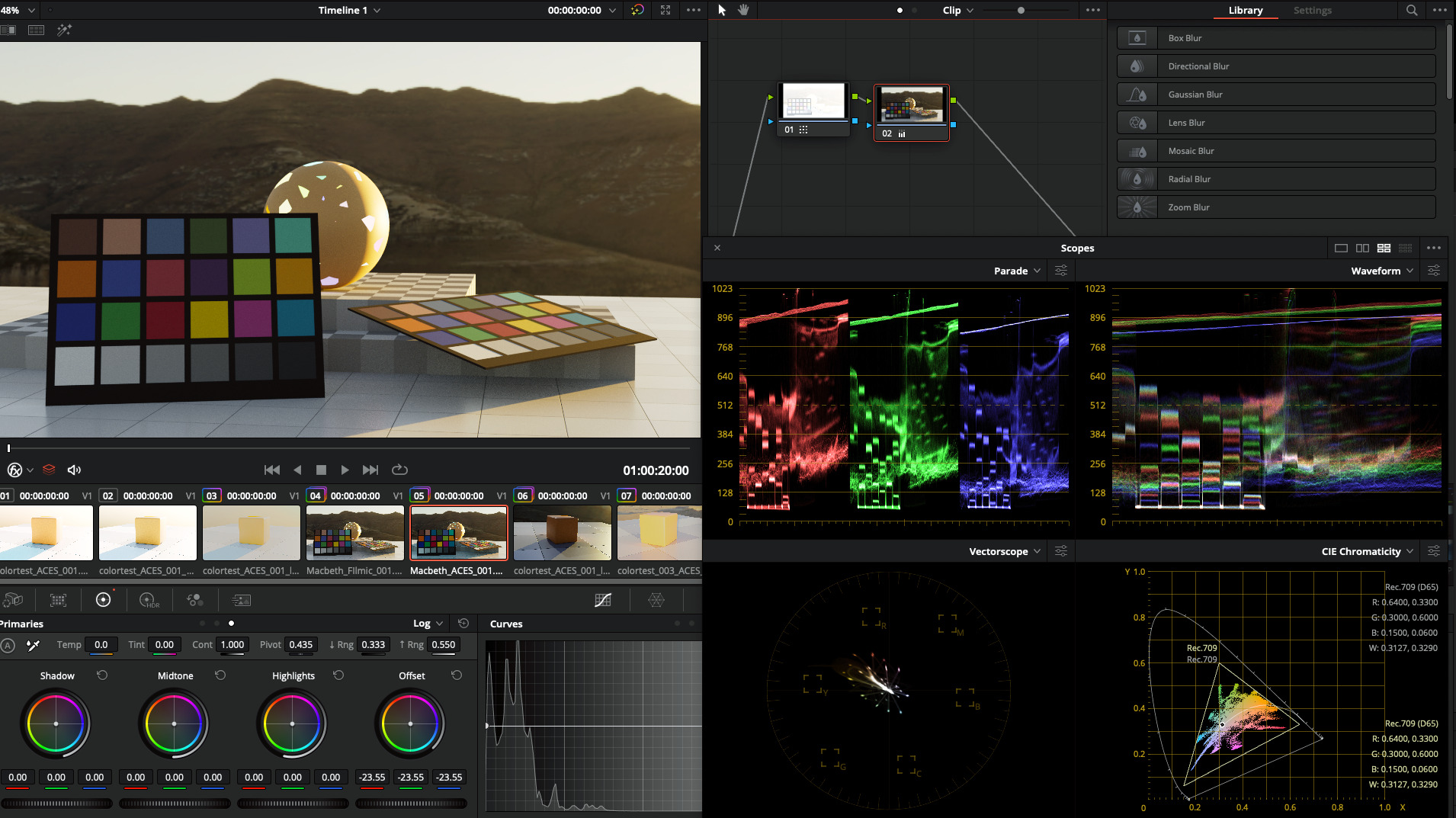

I ran a few tests.
Filmic EXR vs ACES EXR, exact same scene, same frame rendered in Blender 3.0, Cycles CPU.
Placed into Resolve, set to ACEScct Color managed.
And I found only very subtle differences in performance between Filmic and ACES.
Bypassing the input transform and using CT in the first node gave terrible results, unusable…
but, setting the input transform to ACEScg and no CT gave very usable results, both for Filmic and ACES.
The image was designed to stress the system a bit, with an HDR background set to 100 intensity, a few emitter textures set to 500. To maximize the dynamic range. And a Macbeth chart to have some color reference.
Exposure compensated in blender to look well exposed in the viewer.

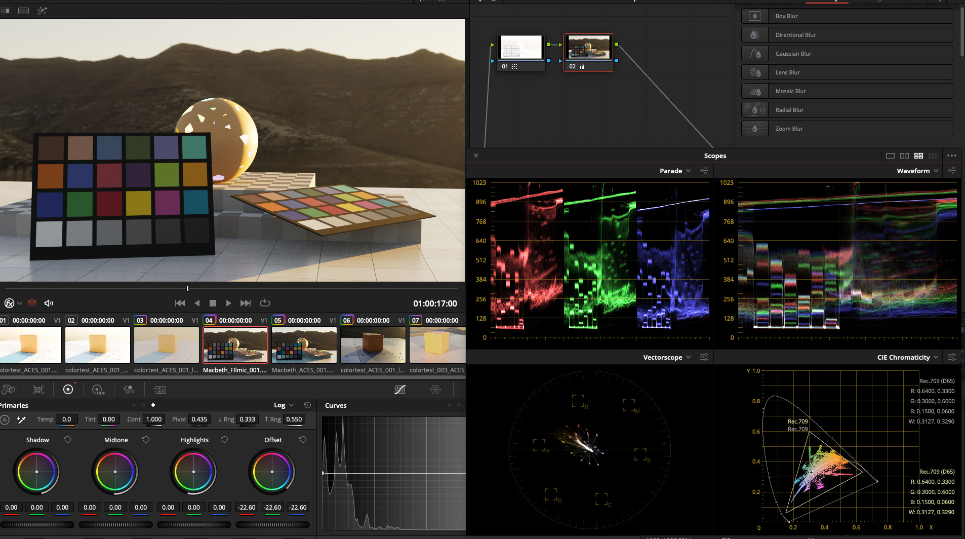

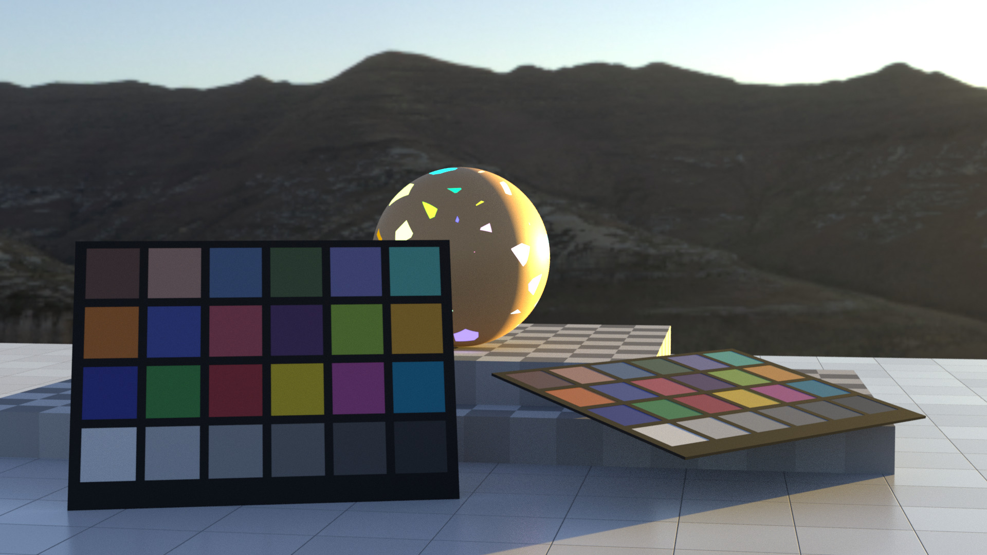

This is the plain 8 bit Blender render:

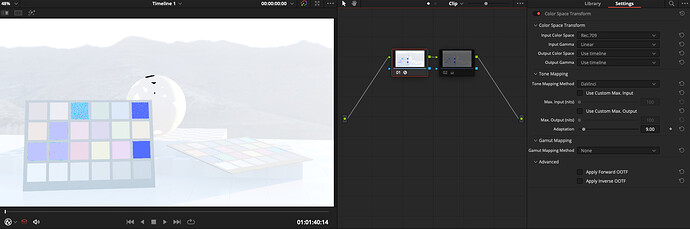

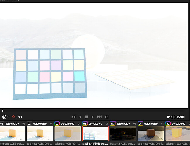

Filmic set to bypass plus Color Transform set to r709/Linear:

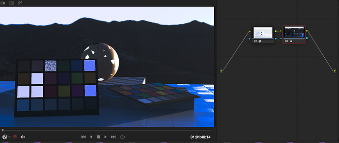

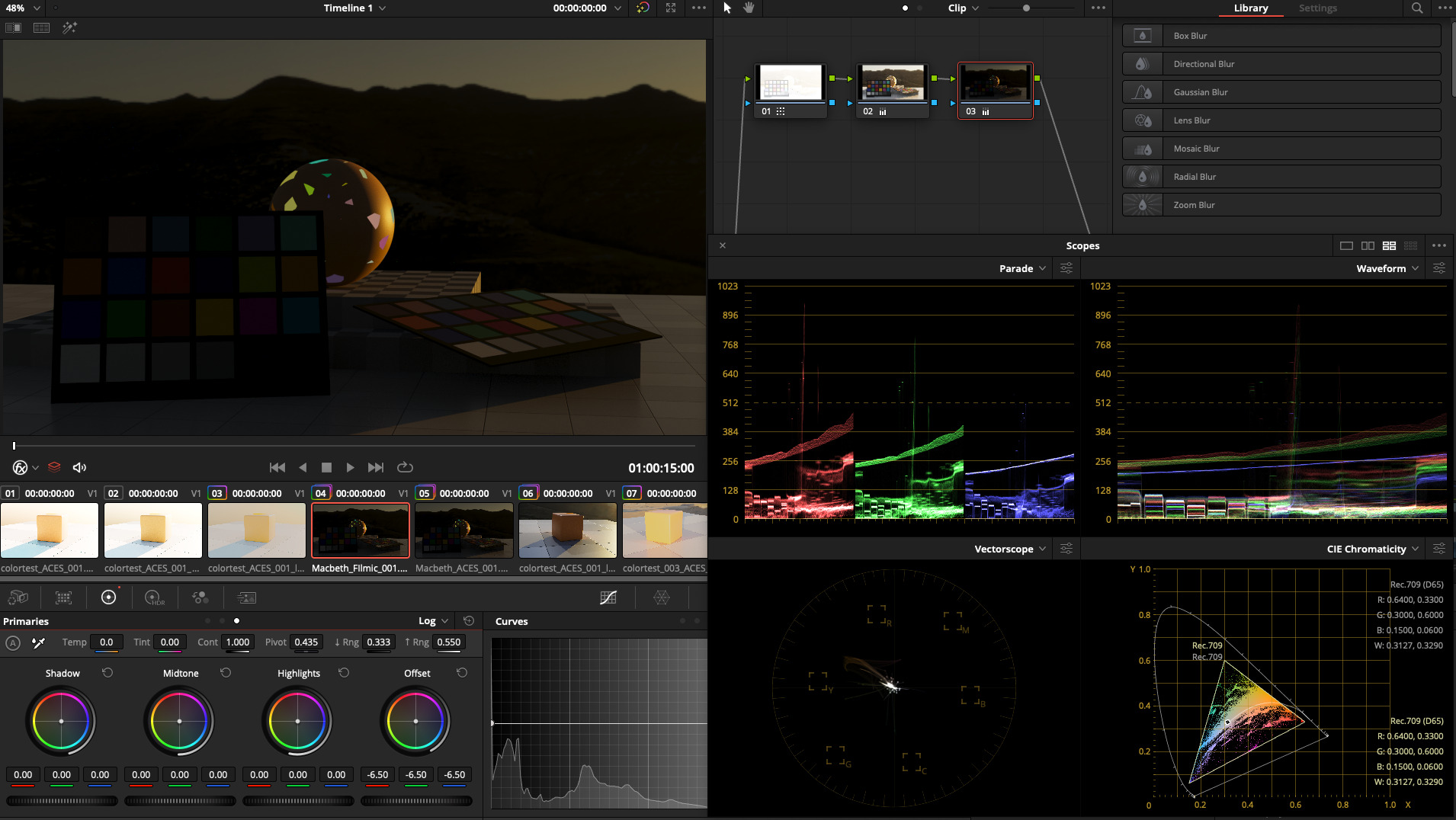

Trying to correct offset down destroys the image:
Curiously (and just so the developers have another interesting fact at hand) if the gamma is set to some Log profile the data falls into place… (and it’s NOT Filmic Log, it’s plain Filmic). Any log profile has a similar effect, with some minor differences:

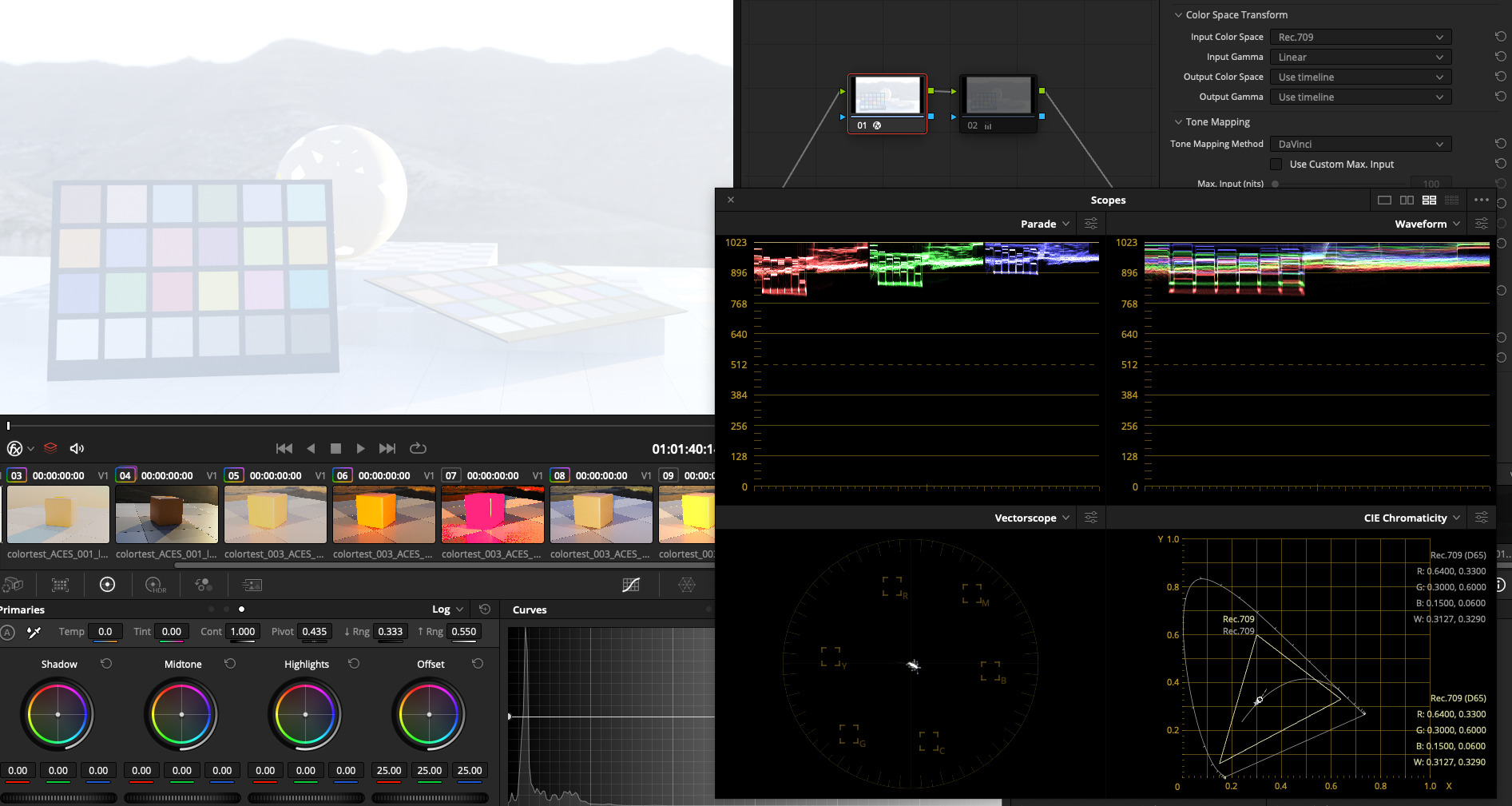

Using the ACES version with bypass and color transform yields a very similar result, here:

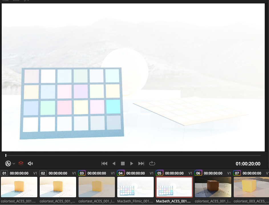

Now, this is the Filmic EXR, just set to ACEScg input transform, and no CT node at all:
And the ACES, same settings:

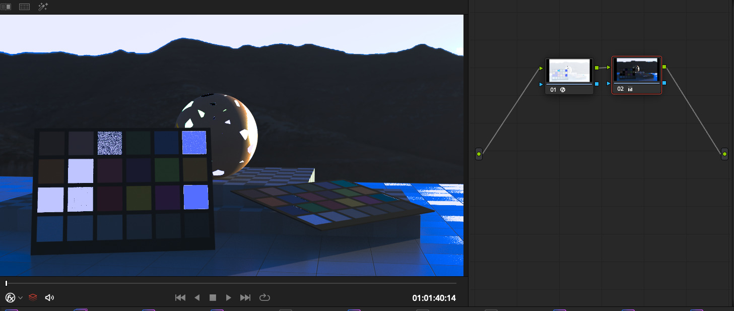

But both could be recovered easily using just the offset and colormatching the chart for balance.

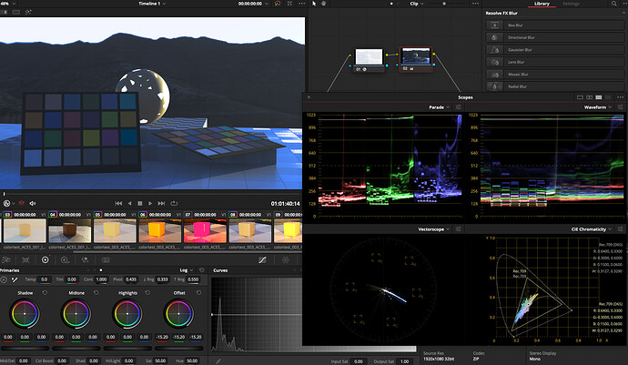

Filmic:
And ACES:
There’s no discenible difference in performance between the two images.
And pushing the image further down never breaks it, both fade gracefully to black without any artifacting. All values are kept inside Rec709 at all times, except in the extreme darkening, but that is expected due to the lack of saturated blacks in Rec709.
The winning ACES worflow for both Filmic and ACES is to just set the input to ACEScg, and balance and correct the image as needed.
So far the test in Resolve/ACES, I’ll do more tests in a Davinci Wide Gamut space to see how it goes there.

This is wrong.
The light data would be AP1, and “proper ACES” will expect AP0, so the chain is wrong.
This would be the correct approach to tag the light data as AP1, but totally incorrect for Filmic. The proper Filmic chain cannot be achieved in Resolve without starting from Filmic log, which bakes the gamut compression into the encoding.
Both results are a sloppy mess.
Not at all. Pretty clear to see how the imagery ends up nightmare fuel.

So? You mean that in plain (unmodified Blender) I can export EXRs in nonlinear space and choose the Colorspace? How is that done?
If you try to grade a 16 bit PNG you will run into issues because not all latitude data got enconded in the file and something got either clipped or rounded. That’s the issue I was talking about, I wasn’t questioning the theoretical infinite radiance that Cycles may be able (theoretically) to handle. My point is that grading 16 bit files is not ideal if you can export the full range of data in EXR.
mmm, nope. I cannot decide arbitrarily the encoding and you know that.
I MAY define arbitrarily whatever combination of colorspace and gamma is reading the image. But that image was encoded using ONE combination of those primaries, white points and transfer functions.
And to be able to use the image in a color managed environment I need to be able to tell those, precisely (ideal) or approximately (not ideal at all, but usually better than display-baked-8bit footage).
According to the Blender Manual, the right encoding for EXRs, whatever the transfer function, should be Rec709/Linear gamma. But if I use those the image breaks. That’s my whole point. It really breaks.
So, completely clueless about how the image should be interpreted, I ran lots of trial and error until some combination held better. These are my findings nothing more.
I think you are missing the point here. I know that a 100nits tv cannot output 4000nits, as I know that in a CMYK printed book you can’t have the kind of 0xFF0000 red you may get in a 1998 CRT monitor. But still you take a photo of that monitor, and SOME red is making it to the printed page. To make all that obvious transformations nicer is that we mess with the Rabit Hole of Color Management.
I’m trying to find a way to map elegantly the beatiful internals of Cycles rendering inside Resolve Color Management, while preserving most, or ideally all of the original data to have room for corrections.
I don’t see any out of place “skew”.
If you are talking about the visible diagonal in the waveform near the highlights, that’s a color cast, and a gradient, caused by the “outdoor” environment image that casts a bluish light on the scene, from a definite direction (the sun), hence the gradient, seen as a slope in the waveform.
And if you are talking about how that slope changes it’s angle, that has to do with how Resolve manages Offset and primaries in colormanaged environments, both ACES and DWG. Resolve “pins” both the black and white clipping points and grades in between. That causes a nonlinear response to offsetting the image. That’s a feature, not a bug and is one of the best selling points of the colormanaged environments. In unmanaged spaces highlights just clip.
Why? the scopes are wonderfully useful. For a colorist. Or a DP at least.
I do. But monitors can be deceiving you know? I think you know that too.
That’s what the scopes are for.
I already do that too. Thank you anyway for the tip.
I don’t know how to do that, besides looking at the chromaticity CIE scope to spot chroma clipping/out of gamut pixels.

that’s a 500 intensity emitter, of course it will display overly saturated!!
It’s a totally unreal situation put there to test the how the image handled the limits.
The saturatio I refered was the overall saturation. Slight, but noticeable. those artifacts are completely expected.
Of course I know this workflow is not ideal. I’m trying to arrive at one.
You tell me how to place EXRs in resolve then. The R709/Linear doesn’t work.
Are you kidding? I’m not trying to achieve anything just spot clipping and weird shifts.
No. I need to see situations closer to what I deal. The devs should to that and tell us how to deal with the colorspace.
I think that’s the way Resolve handles it’s color management.
This is the same pushing but with alexa test footage
[disclaimer: this is just a push and pull of data not inteded to achieve anything]
But of course, Resolve is a crappy piece of amateur software, nothing to take seriously, just like ACES, Netflix, Animal Logic, the Academy and everything else outside Blender. And especially the users that are so ignorant that they don’t know the basic Math needed to write Color management engine from scratch so they don’t deserve to use it either.
I’m done with the tests, If do the DWG tests I’ll keep them to myself, I see there’s no point in finding a solution here.
