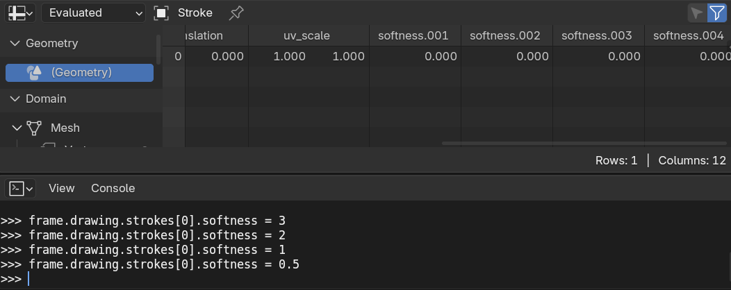

  1. Each time I use high-level API to assign an attribute value, a redundant attribute is created. I think the problem might be in the AttributeGetterSetter, which always calls the new method. Although not visible, I think .selection setter may have the similar issue.

  1. and 3. have been fixed in todays build.
I think 2. is sort of expected at the moment unfortunately. I’m working on a proposal that would change the way this part of the materials would work. This would also solve this issue. Not for 4.3 though.

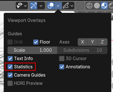

One of the issue might be a very low Advanced > Spacing setting. Anything below 50% might result in too many points being generated.
You can check the point count by enabling the Statistics overlay here:
