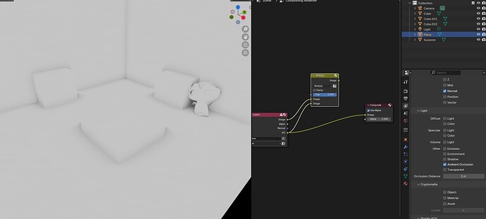

Quickly regarding AO…
Multipass viewport compositing (currently EEVEE only) recently landed in 4.3, which means that you can use the AO pass in the viewport, which some of you may find more satisfactory as a direct 4.1 replacement.

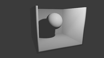

Downloading this user’s file…
…I get such results:
I didn’t change anything about their file. I simply opened it up in 4.1 and hit F12. Then opened it up in 4.2 and hit F12. These are the render results.
Testing with the file provided, I can confirm that if no settings are changed, you get results like the ones shown.
But if settings are changed (E.g. You select the light and disable the Absolute resolution limit setting in Light Properties -> Shadow), then the shadow quality drastically improves.
Ah. So it does. That’s one less thing to worry about, thanks.
