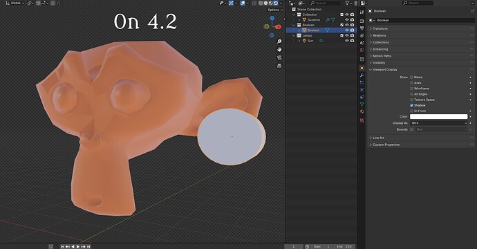

Here’s the problem:
I know one can use the Material preview mode, but then every time one switches to render the Booleans block everything forcing to hide them and then un-hide to make adjustments, swith to material, switch to render, hide etc… it’s a bunch of waste of time.

I’m not a EEVEE developer, so what every I say could be wrong. But I am doubtful the EEVEE developers will change this behaviour so that “Viewport Display As” has an effect in the rendered viewport mode (the mode you’re using in the images).
This is for a few reasons:
  1. This aligns with Cycles.
  2. You’re in rendered mode, ideally you will want to see the scene as it will appear in the final render and having a “Viewport Display As” mode impact things negatively impacts this goal.
  3. There is a new option to hide these objects in rendered viewport mode. It’s in Object Properties -> Visibility and is controlled with all the Ray Visibility ... options (E.g. Ray Visible to Camera).
Haaa I see! :face_with_monocle: :astonished:
Alright… I hadn’t notice it! Thanks for the heads up! It’s a solution indeed!
…This was the easiest fix ever :laughing:
…all good, real thanks!
The big issue people are having now is that if they’re in material preview mode, and Camera ray vsibility is off, their object is invisible no matter what Viewport Display As settings they have, which is interupting some boolean workflows.
There is a dicussion about whether or not the ray visbility settings should impact material preview mode for this very reason, and so the behaviour of ray visibility in material preview mode may change in the future.
In “Display as Wire” it’s always visible on all modes.
Only in “Display as Solid or Textured” the object indeed disapears in Material mode.
Oddly enough, it could be said that Solid and Textured doing anything in Preview or Rendered mode was just a bug in the past. The tooltips say the following, and have since forever:
Solid - "Display the object as a solid (if solid drawing is enabled in the viewport)"
Which it’s not. Material preview was enabled above, not Solid shading.
Textured - "Display the object with textures (if textures are enabled in the viewport)"
Which it’s not. The textures mode is only an option with Solid shading mode.
