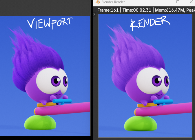

In today’s Beta build, Eevee Viewport and Render can have big discrepancies.
Sometimes the viewport can change (and match render), but I’m not sure yet what causes this change. I wonder if it’s related to viewport’s differences in sampling.
EEVEE_ViewportRender

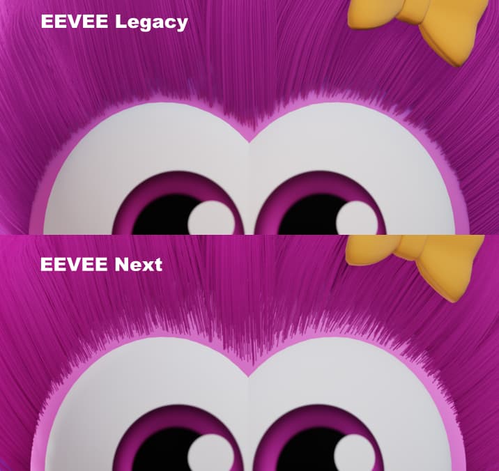

Contact shadows indeed makes huge differences. Without it, hair roots jump out immediately.
EEVEE Legacy also had the benefit of SSS on the skin blending the hair even further.
I would love to have that SSS blending back, that was really handy in many cases.
Indeed, I’ve been tinkering with shadow settings to get some shadow under hairs with very little luck. Contact shadows may not be physically correct but are so much better looking to ground specially fine or small geometry

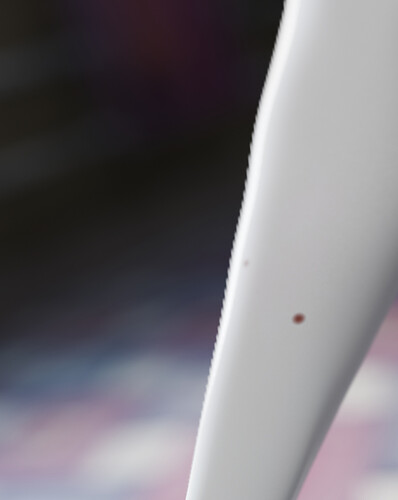

Am I the only one seeing things like this? Pick a really shallow depth of field (I use camera with f-stop 1.2) then have a strong rimlight capture a bright highlight on an edge that is itself reasonably in-focus, but the background very out-of-focus.
You will get these extremely large and obvious jaggies. Important note: these are not pixel effects. The jaggies are probably 5-10 pixels in size. It’s in the render.
I get a similar effect when I use DOF in Workbench renders. When there’s a really large amount of background blur, then an edge in focus has weird halo. I’ll attach an image of the problem in Workbench with DOF.
The Workbench halo has been a problem with that renderer since the 3.x series at least. But the jagged rimlight effect is new to Eevee Next.
UPDATE: I think the jaggies only happen in the viewport. I’ll do a few more tests, but at least my initial “render this frame” test yields no jaggies.
