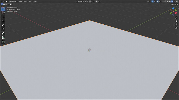

Hi @fclem,
Expected overlay behaviour, or would you like me to create a bug report?
Steps:
  1. Load Factory Settings
  2. Delete default Cube
  3. Add Mesh > Plane > then scale x2
Workbench
Cycles
EEVEE Legacy
EEVEE Next
Kind regards.
@David_Black it looks like a bug to me because if you switch to the top view (EEVEE-Next), the overlay disappears.
