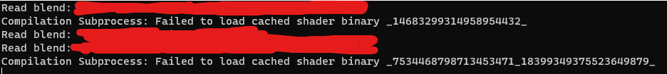

Not sure if this is a bug but the console sometimes throws this error(?), but it seemingly doesn’t affect anything.

How often does it happen?
It’s not something that should cause any issues on the user side, but it might be a symptom of something not working as it should.
This just means Blender tried to use the cache of a previously compiled shader, but the driver has failed to load it.
It can happen, for example, that after a driver update changes the cache format and cannot be used anymore, so Blender is prepared to handle such cases. But it could also be an error on our side.
What’s your OS/GPU?

I get this on two separate devices with Windows 11, both with a Nvidia GPU. It seems to occur when i enter rendered view for the first time after opening a file. One it consistently happens on is the 4.1 splash screen from demo files.
There is also a crashing issue which can be reproduced on the 4.1 splash screen blend, that the file can randomly crash when entering rendered view #122924 - EEVEE-Next: Files randomly crash when entering rendered view - blender - Blender Projects, however this is most likely not related to subprocesses (unless it was broken by #122232 before the other patches were merged), as this started occuring before subprocesses were finished. I’d appreciate if this were looked into soon.
Ok, I have the same setup, so I’ll take a deeper look at it tomorrow.
Thanks!
