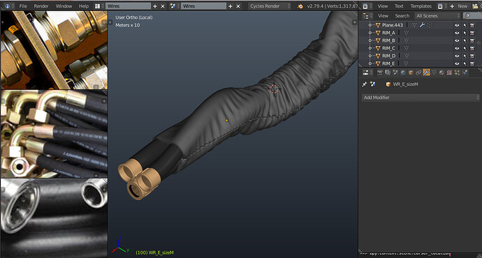

This seems optional, but it’s important to understand how much easier it becomes to manage bigger scenes. Big scenes and assets always compose of subsets (e.g screws, wires, detail > engine / interior / steering → final asset(boat,car,airplane etc) or foliage / furniture > assemble and architectural render). Isolating these elements into separate scenes results in clarity, ease of management and speed (such as rendering previews). It’s very desirable to have specific workspace with specific reference loaded. Example:
For animation you might have editable assets in different scenes or assembly of master scenes out of linked assets. In addition any particular renderable Scene will likely needs specific editors open (you might be animating character face closeup in one, setting up VFX in other, perhaps populating scene with foiliage/particles in third etc).
Such detatchment of workspaces ↔ Scenes (unlike Screens and Scenes) will make complex projects a lot harder to manage. What makes situation worse is that currently there seems no way to set Workspace with Python? bpy.ops.workspaces.workspace contains no applicable functionality so even if this is considered user cannot currently do much about it:
