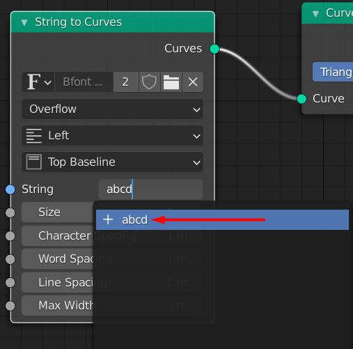

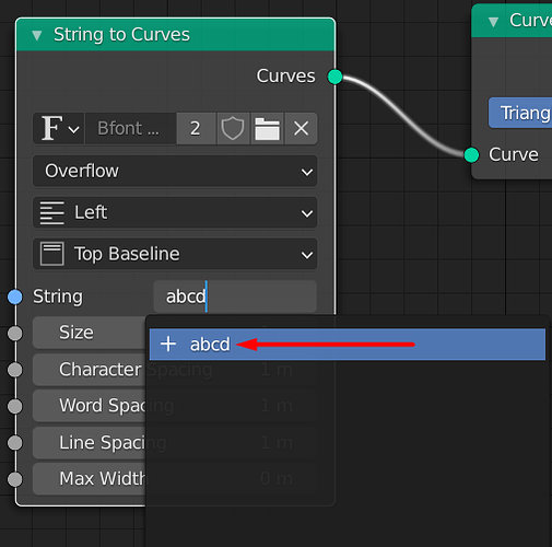

Can you please get rid of the attribute search in the mograph related nodes?
It gets annoying to click or press enter every time I want to change it.

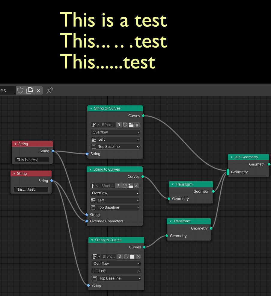

I’ve been playing around a bit with different effects and realized if part of a string is replaced with other characters in an animation, the layout will also change and cause flickering unless a monospaced font is used. This lead to experimenting with a new input on the String to Curves-node called “Override Characters”. When this is used the main input will generate the layout, and the override will be the characters distributed at those points. You can see this in the image below.
I think this can be a useful feature for effects like “Decoder” that can be seen near the beginning of this thread. What do you think?

I’m not a pro motiongrapher by any chance, but I think the decoder effect works by using the same type of characters in each character. I mean, if the string being decoded is a word, it doesn’t make sense for numbers or punctuation marks to appear during the decoding. Same for a large number: it doesn’t make sense the letters appear during decoding. My point is: other than ‘j’ and ‘i’, I don’t think decoding strings will be too affected by the width of the character. So, it seems to me that trying to solve the flickering effect to cover every possible case could be misplaced effort.

Yeah I think you’re underestimating the flickering a bit. I made a sample here that better shows what I mean. The middle is using the new override input.

edit: This example makes it more clear how modifying the input string affects the layout:

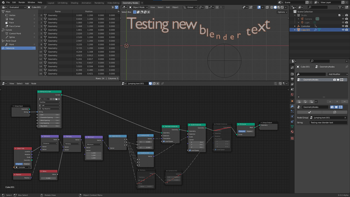

I’m playing the text nodes in the daily build of 3.0. I want to have my string as a mesh object with a certain thickness. Purpose is to do a boolean operation with the rest of the geometry. I cannot do it because I cannot find a way to add thickness to the text. Is that possible at all?
For the time being the only way I know of is using a solidify modifier (there’s a solidify node coming and also the extrude one but I’m not sure when they’re going to land in master)
