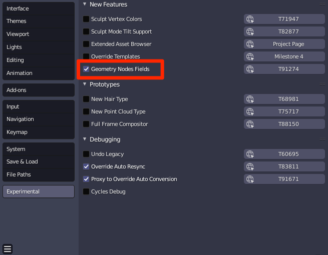

This isn’t possible with the current master, right? I tried replicating it but it seems Index nodes are no longer there, and also there isn’t an option for transforming characters separately (since they’ll be separate nodes moving forward).
You will need to toggle “Geometry Nodes Fields” under experimental in preferences to get fields nodes:

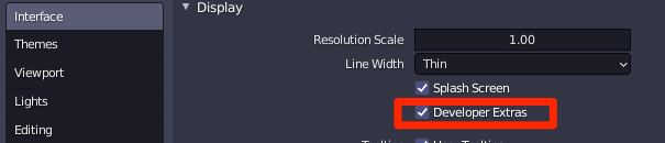

If there’s no “Experimental” tab, you can enable that from Interface > “Developer Extras”:
