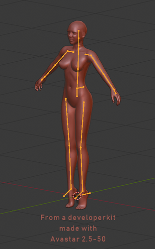

Special note for Secondlife users
The Collada exporter for Blender 2.80 now can export Armatures which have been created in Blender’s native orientation (character looking towards negative Y) You would set the Global Orientation panel:!
- -X Forward (yes, minus is correct!)
- Z Up
- Apply Global Orientation (enabled)
See image below:
Some more details are here:
