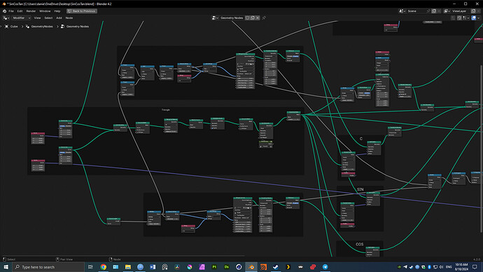

Quite like this! Would also love the ability to click on a specific node and only affect the nodes connected up until that point, because there are times trees branch and stack above or below
So in this case if I wanted to move only the nodes in the backdrop “triangle” I woulda end up moving the other backdrops above and below, which may not be wanted behavior. I think if we had both of these functionalities, likely different commands that would be primo!
Holding V then clicking and dragging on a node does exactly what you described. Only the node I selected and it’s dependencies are shifted. Everything else is left along. It’s also the first action in the demo video in the original post.
Is it not working for you or are you describing something else?
Shoot you’re right sorry. This is what I described just didn’t realize we had that as well.
