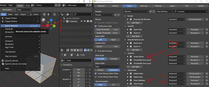

here another example:
why is this?
in the Minimal Keymap Proposal is nicely listen what keys should be kept and whatnot…
how about take them and make for each Unified 1 global shortcut funktion for all editor types?
imagine how nice would be change just 1 shortcut and you set for all editor types and not to dig for hours to change few SAME keys…
