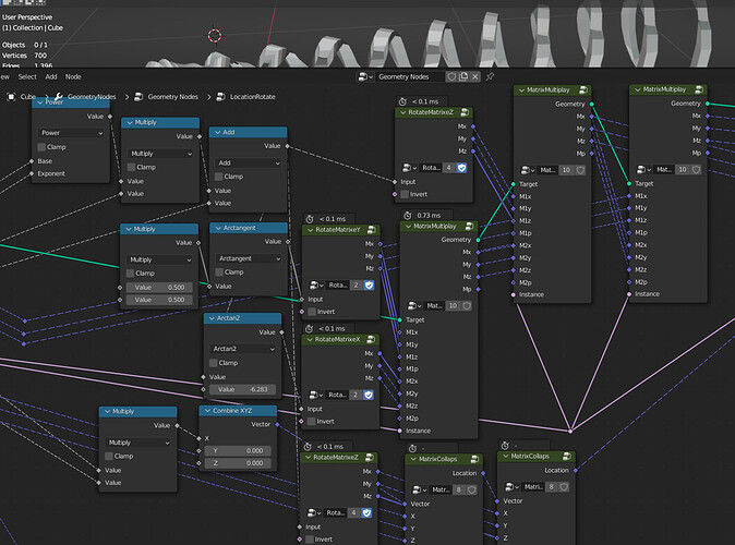

The Shader and Geometry nodes are definitely my favorite parts of blender with their immense power and flexibility, however I find my self at times finding them the most frustrating part of blender. Simple math operations take a LONG time to do especially when you need to chain together results of other operations and use them several times. Not only does it take a long time to do it gets incredibly confusing and messy to the point where you’re not really sure what is going on anymore.
I’ve included a picture of an work in progress project where I’m using blender to create a mobius strip for use in animations for math videos. Which includes only some of the math I’m using. Overall what I’m doing is extremely simple where I’m rotating around the x axis as x increases. But the math nodes make this simple operation incredibly time consuming and complex to perform.
