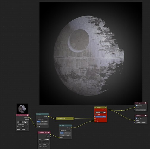

Is it possible that there is an issue with the multiple in the mix node? it feels like there is some kind of curve adjustment underneath which makes the mix response nonlinear.
The mixed image
Look at the difference between 0.25 all the way to 0.75 (the difference is barely visible) v 0.75 to 0.9 and 0.9 to 1.0
0.25
0.50
0.75
0.9
1.0
