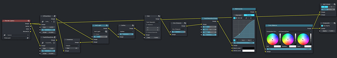

How does one scale an image and still keep the final image within the size of the render resolution?
Here in this image if I scale using the transform it grows beyond the size of the render, if I add a ā€œscaleā€ node and set to render, then the image (the deaths tar should be cropped in theory) does not change at all.
It seems like the Viewer node is not able to preview this type of node sequencing (given this image below renders as intended but not shown as intended).
Here is when it is rendered, see it is cropped properly in the render but not in the viewport.
The Crop mode in the Scale node is probably not what you think it means. The scale node never crops anything, it scales the image by a factor such that the bigger dimension of the image would get cropped if it gets constrained by the render region. The viewer node does not constrain itself to any region, so no cropping occurs and you instead just get the scaling. The composite node constrain itself to the render region, so you get the desired cropping.
