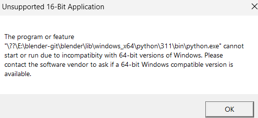

Hi, I’m trying to build Blender using the Building Blender on Windows Guide. I’m not very experienced so I followed the steps exactly through command line. But when I run make update I keep getting this error (see below). There are also three LNK1107 fatal errors in my Build.txt file when I run make. I tried to upload the file here but it seems I don’t have the permission yet. I’ve started from scratch multiple times and I’m just at a loss here
E:\blender-git\blender>make update
No explicit msvc version requested, autodetecting version.
** Visual Studio 2022 Developer Command Prompt v17.9.1
** Copyright (c) 2022 Microsoft Corporation
[vcvarsall.bat] Environment initialized for: 'x64'
Compiler Detection successful, detected VS2022
This version of E:\blender-git\blender\lib\windows_x64\python\311\bin\python.exe is not compatible with the version of Windows you're running. Check your computer's system information and then contact the software publisher.
