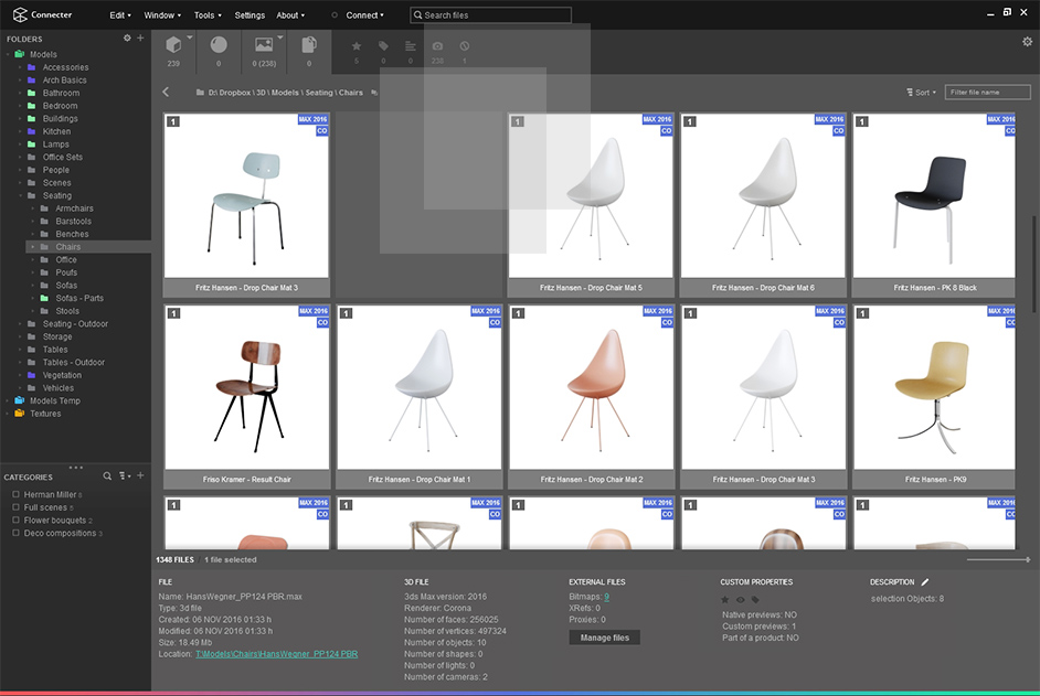

@Draise
I tried to use Connector, and it has a lot of potential and 1 glaring flaw and one minor one that I ran into. The glaring flaw is that it only accepts .blend files â no obj, no fbx nothing else at all â that alone makes it basically unusable, because I am not going to take the time to convert every single file that I download to blend file and upload it to Connector. the minor fault is thumbnail renders which are ugly
