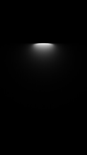

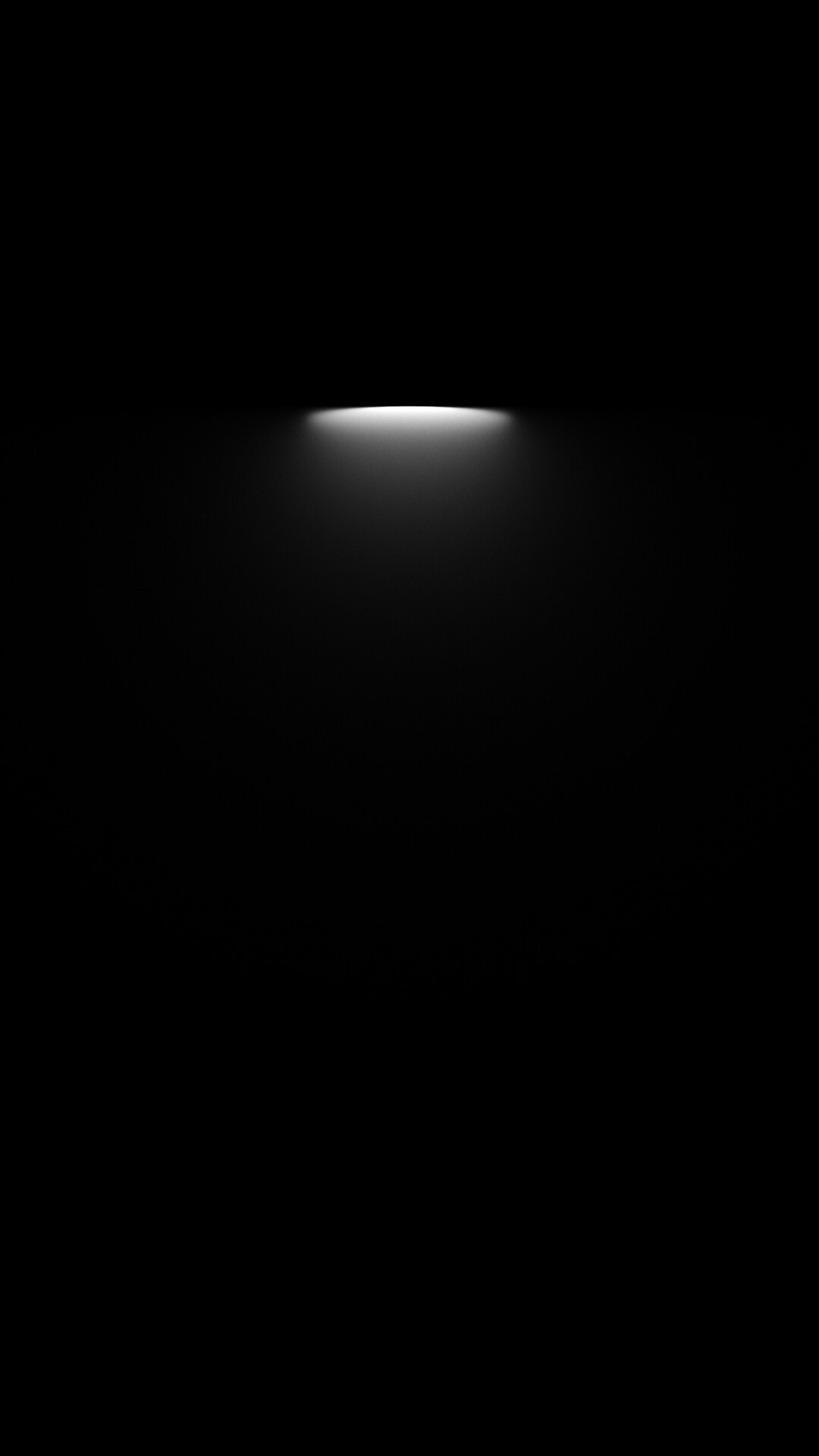

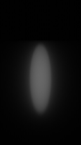

The subsurface anisotropy seems to be isotropic in some cases, specifically when the light direction, rather than the camera direction would cause the most noticeable effect of anisotropy.
This was the test I’ve used where it’s clearly visible (small beam of light with a large incidence angle focused on a spot), the right image is how I’d expect it to look like:
Any relation to this?
There may be, but I don’t think that’s it and don’t know how to test it either apart from building it from source. At least in my simulation the result is still highly anisotropic when switching to isotropic after 9 bounces, though the appearance does change. In blender it’s completely isotropic for this test case, so I don’t think turning off this optimization should change much.

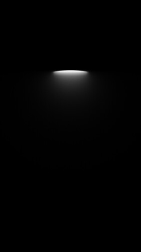

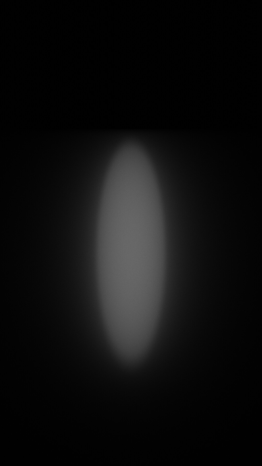

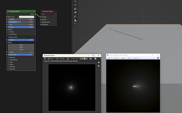

I did a test with a keyhole and an infinite light.
RandomWalk, aniso 0
RandomWalk, aniso 0.9
Try putting the camera at normal incidence to the surface and the light spot at a grazing angle (like in my example). My guess is that the SSS is assumed as separable after the ray exits the surface (or some other simplifications not accounting for the light direction), this would explain why it looks like this in my setup.
There is an effect, but it’s very small, so it’s not impossible that this is a limitation of the method. I’ll try to compare with other renders if I have time.

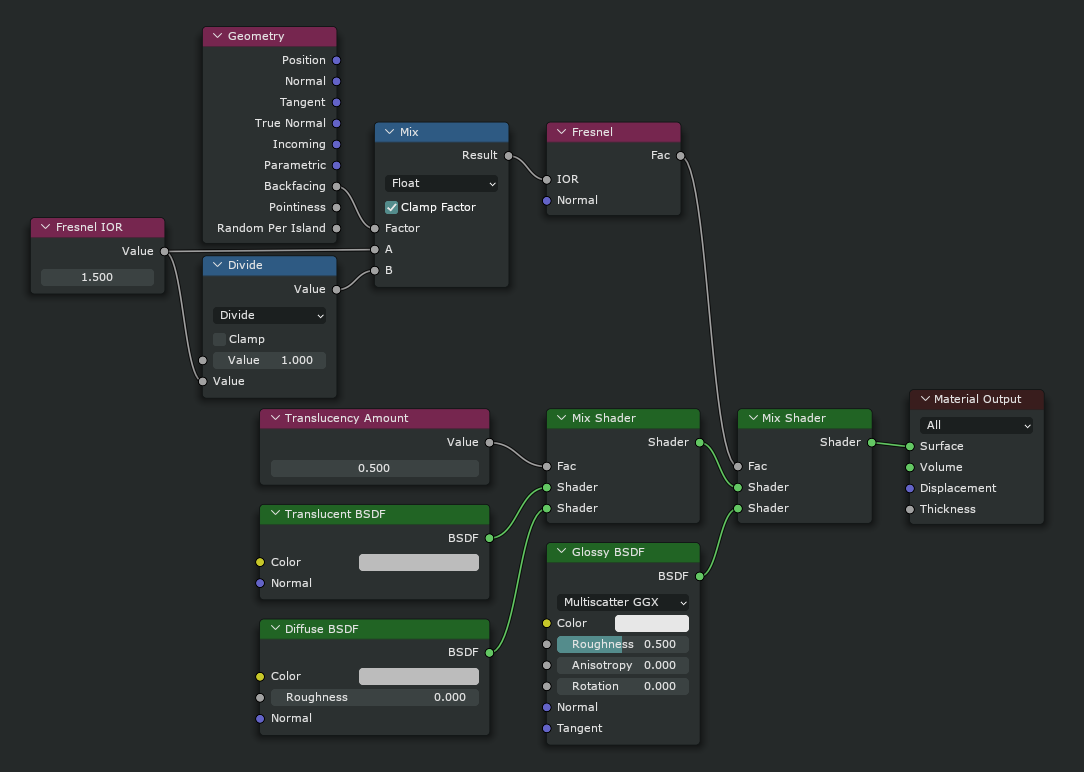

Yes, exactly! What happened to the plan to add Thin Translucency to Principled? It’s been over 3 years :disappointed_relieved:

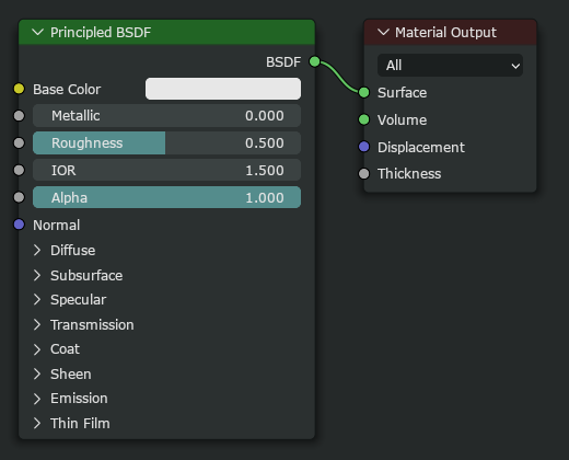

It’s very frustrating, because 90% of Cycles materials can simply look like this:
{B7C8CFD6-8EC9-458F-A5DD-C1DEBA2A909F}
But then there’s the remaining 10%, like Tree leaves, grass, paper, curtains, lamp shades, etc… that have to look like this (if they are supposed to be at least remotely correct and look right):
It’s such a PITA having to set up so many nodes for such frequent types of materials :confused:
