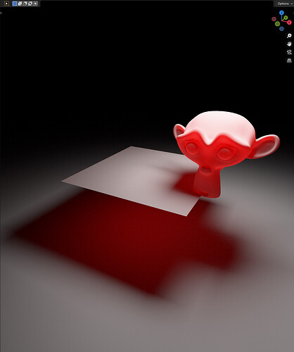

Can I ask why? I guess I don’t know.
As far as I can see, diffuse and translucency are mutually exclusive, just like with mixnodes, only in the case of mixnodes the maximum value of each shader at a point in time is limited by the fact that it is truncated by the mix value.
If we use what I suggested - At each moment in time we have 100% of the shader, no more. And we will see either diffuse or translucency, but this will be controlled by the incident light, just like with mixnode.
I’d like to hear your opinion. What’s wrong with this case?
Add
Mix
Add
Add
Mix
Mix
Add
Mix
Add+inv multiply
Only add
It doesn’t actually matter if it’s mix or add, it is “correct” only when leaf/transmitter surface is pure diffuse and that’s not the case here…
Yes, ideally you first have to mix translucency with diffuse, and then put reflection on top. All the more reason to have it integrated in Principled BSDF because the amount of knowledge average user needs to have to set this up correctly is overwhelming for many.
