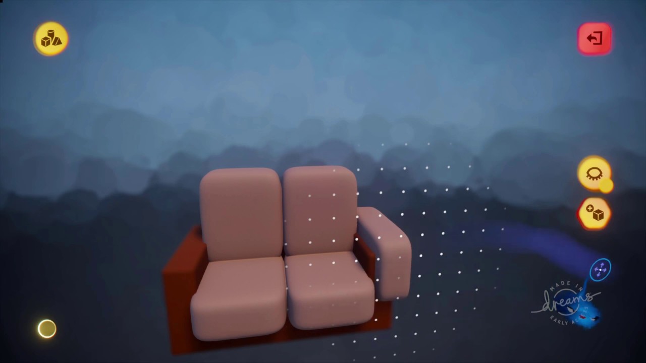

Just look at how this game takes it to even another level by allowing users to make brushes out of a collection of objects!:
This it the power of being able to add objects to a container quickly!
