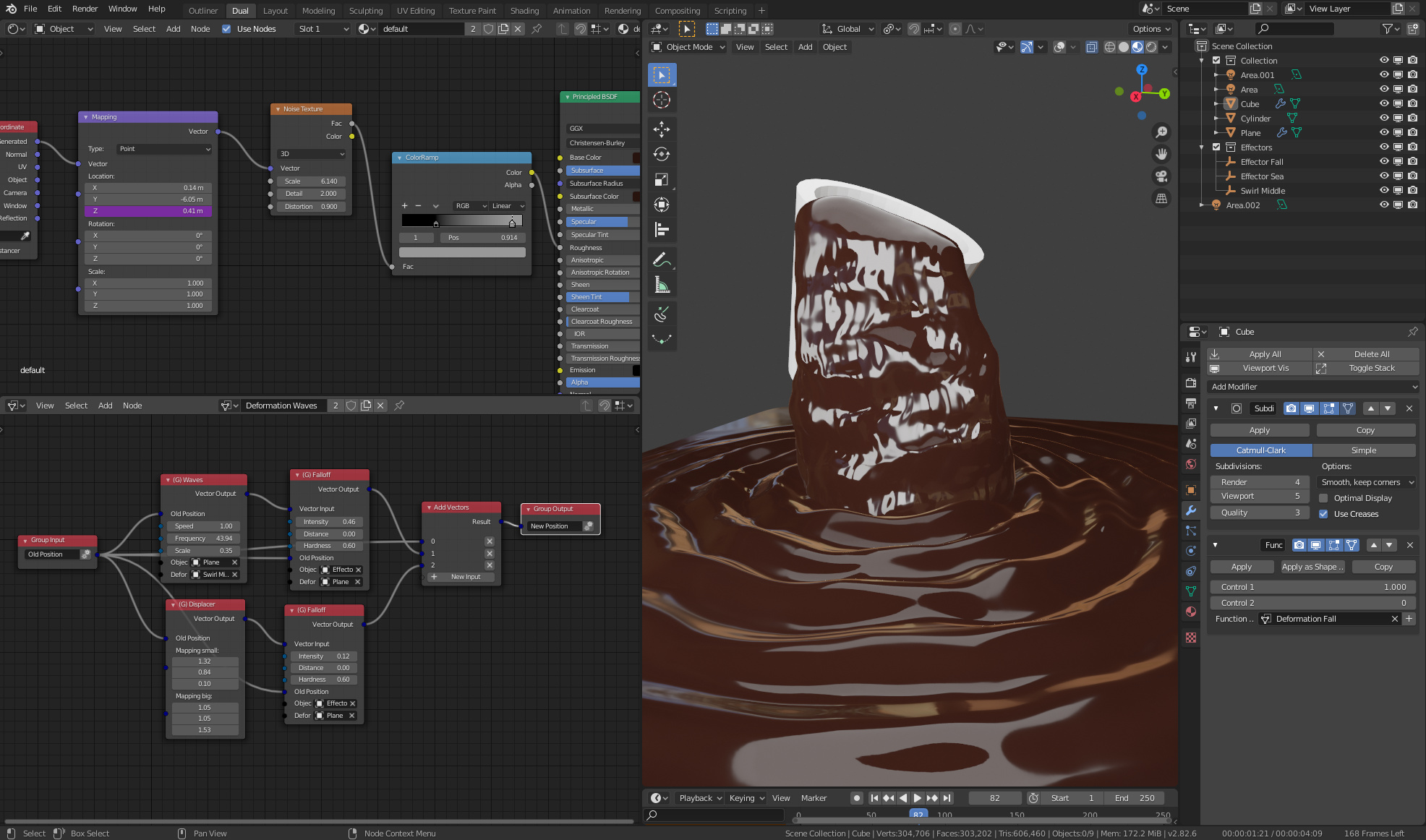

I can’t believe how easy it is to build deform modifiers now.

@DimitriBastos inside this Blend is something like a Falloff node, could be changed so it would work with particles.
File: https://drive.google.com/open?id=1yTEukvS1ion_5FbBUDPNV_tuUxvZeo_i

Wow. What’s happening here?
I’d love to see the insides
Just download the file
Didn’t see that, cheers !
