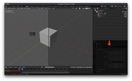

One thing I noticed is the lack of an indicator for how remainning editors will fill in the void. This is not always immediately clear.
I’m also still a fan of small “this area is interactive” indicators in the corners.
Is the overlay themable? It won’t work well with light themes.
One thing I noticed is the lack of an indicator for how remaining editors will fill in the void. This is not always immediately clear.
No, but in a lot of cases it isn’t really possible to give feedback on the immediate operation (what you are moving) and the final result at the same time. In simple cases I could probably do something, but a lot of times even if I knew what was going to move it would be hard to show it as a meaningful feedback while it is proposing docking targets. But I can see what what I can do to improve that. I just wouldn’t want that to delay getting this out of Experimental since that is an issue we have now without docking.
It works well on the official Light theme. The divider line is using the theme color for “Editor Outline” while the info at the cursor is using the tooltip theme. Yours is using white between editors and is using white as the tooltip background, so it appears to showing as I’d expect it to. Feels okay though.

The official light theme is more of a grey / high contrast theme. With an actual light theme (I’m using Piano White) the fixed white transparent overlay doesn’t create enough visual difference between non-impacted areas and the area you’re hovering. The issue is that the area you’re hovering becomes the primary focus of the user and the cursor becomes secondary. You could go as far as hide the cursor and the feature would remain nearly perfectly functional. So having this primary focus stand out enough is important.
A solution could be to use one of the text colors as the overlay color with a fixed transparency of 10% or so.
Why should developers be expected to completely change a patch to match one single non-official theme?
