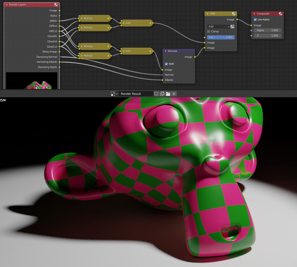

You can also get much better results by denoising direct and indirect light separately. This is because indirect pass contains most of the noise and has much smaller brightness range. You can even get away without denoising the direct pass at all (also avoiding OID blurriness). It would be great to have an option in Cycles to output exactly these two passes).
Raw direct and indirect:
Node setup:
