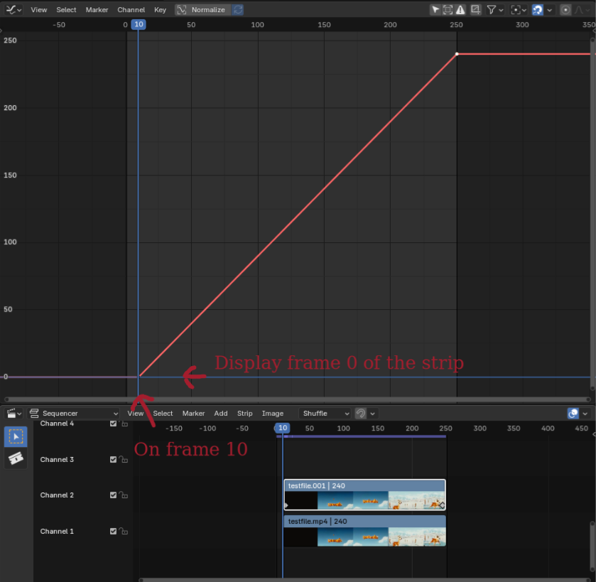

On channel 1 is the original video strip, that is only moved to start at frame 10. No changes to the handles or retiming.
On channel 2 is the same strip, also moved to start at frame 10. On this strip I will show what each kind of change does to the strip, and retiming data.
In the graph editor is the retiming curve for the channel 2 strip.

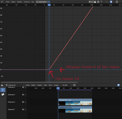

First is an example with no changes to the speed/timing of the strip:

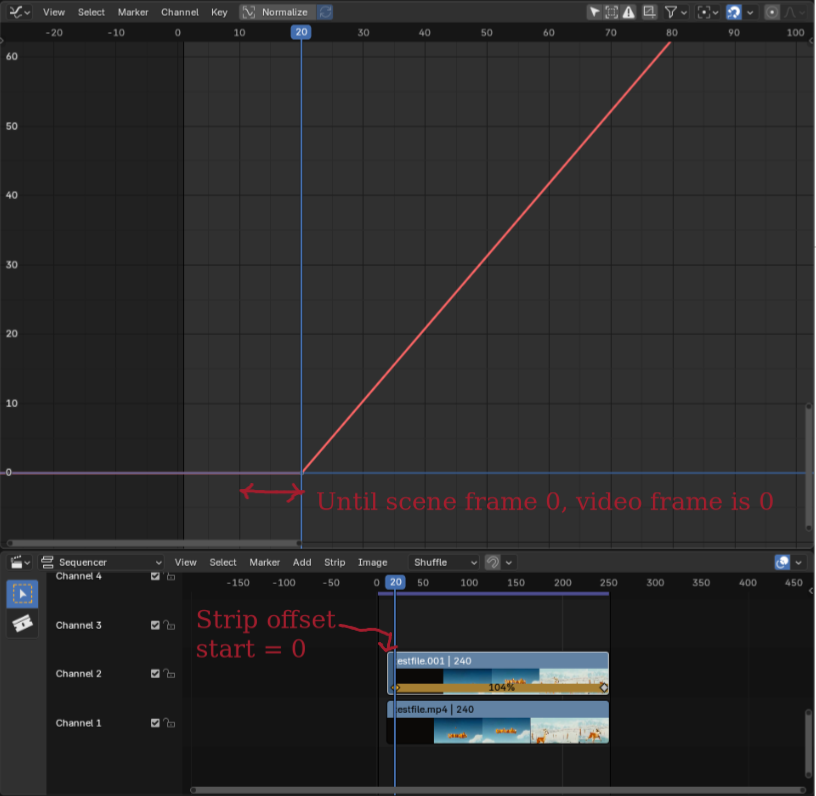

Zooming in on the timeline to further illustrate the next examples:

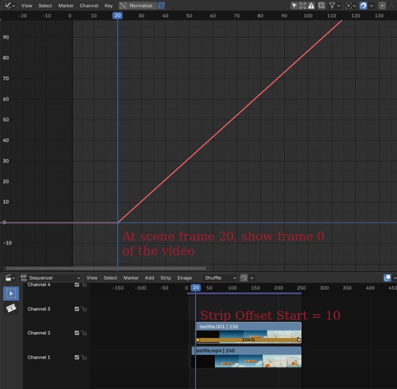

As we move the left handle (but not the retiming key!), the f-curve stays the same:
(On a side note, it would be nice to have an indication that there are non-visible retiming keys to the left/right of the strip. Maybe that could be part of a stretch goal. This doesn’t have anything to do with this specific change however.)

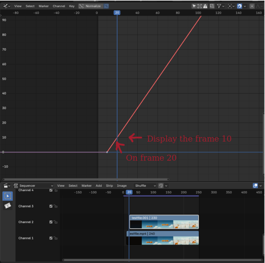

Contrasting it with the case where the keyframe is moved in the graph editor. Now, until frame 20 the y-value stays at 0, so there’s effectively a freeze frame until frame 20. Graph editor changes have no effect on “Strip Offset Start” or any other property of the strip, so the length of the strip is not changed, and there is no need for any special code to update it:
