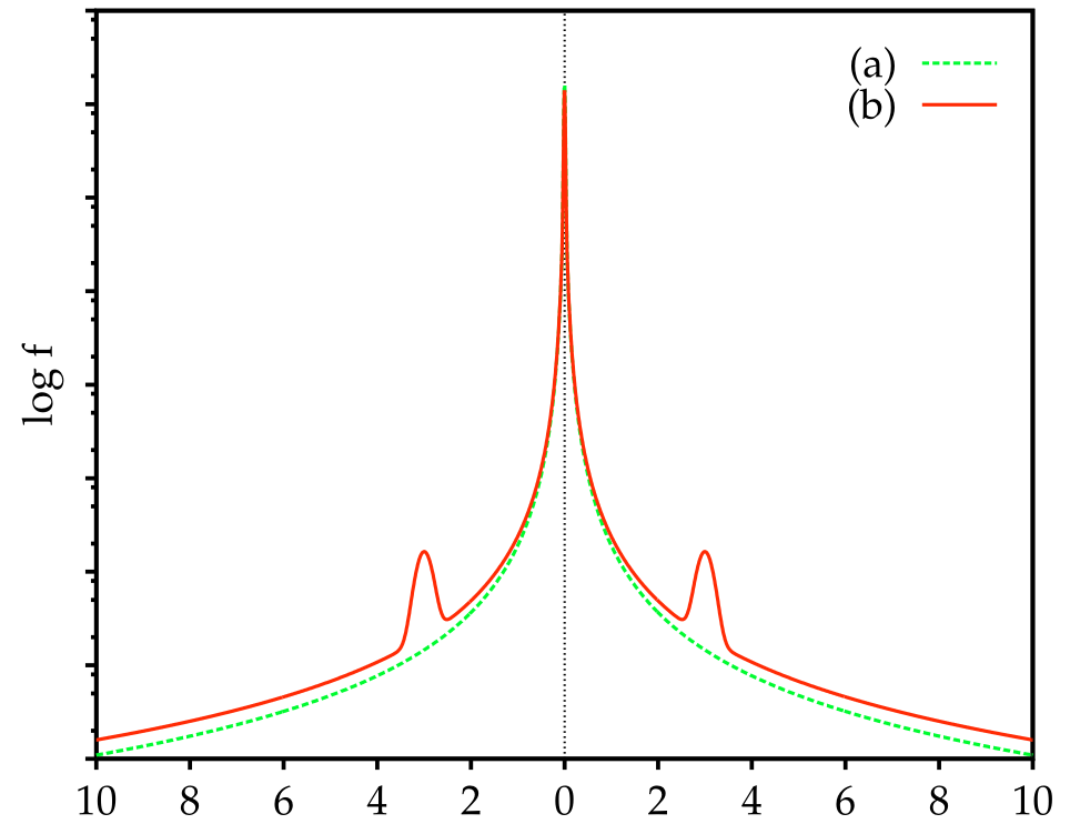

Designing a recursive exponential filter with adjustable parameters to control both the rate of change and the filter’s curve support (i.e., its radius). Reference [1] presents insightful equations that can serve as a foundation for developing this filter, with the following graph closely resembling our desired impulse response (the green curve).
Figure 1: Plot of a point spread function discussed in reference [1].
Also as discussed previously in the general improvements section (quality setting independent features); the radius parameter will be implemented resolution independent.
Also for a more realistic and intuitive result, at the center of the streaks instead of simply adding the streaks we would take the maximum in the overlapping region.
Finally simple star would be re-implemented as a special case of streaks (at streaks = 4), where the gaussian-like impulse response would be an exponential response.
