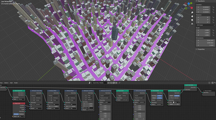

I showed parallel progression but the image was removed. Here is a mockup of how attributes could work better.
Current Design
Proposed Design
The proposed design seems to be in essence the proposed Attribute Processor Group. What I am proposing is that there should be a way to loop new attributes linked to a specific geometry back in main stack without duplicating the actual geometry. Sure, if additional groups are needed, they can be created, yet, if they must always be needed, it would be hard to understand the node flow.
Useful nodes to have
Edge instance node with tangent direction and Face instance node with tangent direction nodes would be needed to get these buildings to follow the orientation of the street edges.
Cars, benches, traffic lights, and potentially people could all be scattered if there is a way to control the direction.
Further on
This is just some food for thought to think about
Wondering if the instance could have indpendent modifier stack without a big performance hit? Reason being is that at the moment all the buildings are scaled based on the attractor distance. Yet, it’s a little more complicated with buildings as they don’t scale up in height but instead should have additional floors.
A system that allows lightweight instanced performance yet allows to change the array number of individual instances, along with tangent based nodes would make creating cities super intuitive.
The parallel progression example has been thought over multiple times already. I think it was actually in the original geometry nodes ui mockup before. It always breaks down when different topology comes into play.
Not quite sure what you mean by this or how it could be useful. Attributes are topology dependent. Can you elaborate?
Would be nice to have curve based point distributes for following lines. I believe I saw someone wanting to work on a points from face center as well. You should be able to construct rotation from tangents there.
Wondering if the instance could have indpendent modifier stack without a big performance hit? […] buildings as they don’t scale up in height but instead should have additional floors.
At that point you no longer have instances but new geometry. You might be able to solve this by breaking down the buildings into instancing floors based on lines of points or even in the future when the project grows instance their facades based on point frames in order to give each building that needs extra detail it’s own look. I believe this is the current preferred approach for doing procedural buildings nowadays but geo nodes might be a little far off from that for now.
Probably recursive iteration over the whole topology. Any new geometry created during would be included in the next iteration. Something-something along those lines I’d guess.
I’m not sure you are thinking about the same thing but that would turn into quite a mess. I would rather have explicit loops over ranges and domains to do this kind of thing.
