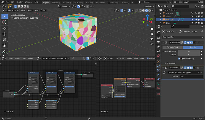

I also found my new favorite feature of geometry nodes: storing the vertex position as vertex colors and using those as coordinates for the shader nodes. Means I can use 3D procedural textures that deform with the mesh - no UV unwrapping or dealing with seams!
This sounds very interesting, can you please post a screenshot of your node setup for this?
Wait, can you now read custom attributes from geometry nodes in a shader ?
The setup itself is super simple. And after trying some different things I found out, that you don’t even need the vertex colors to store the coordinates. You can access (some of) the attributes directly from the shader! (@statix)

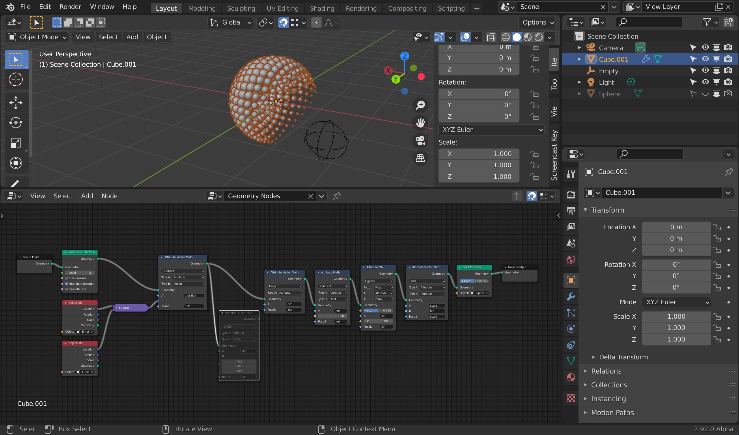

Here is a simple demo that is deforming the mesh after storing the vertex position in an attribute:
Some things I noticed:
Here is the setup with the default cube. The subdivision modifier is only there to help evening the interpolation of the vertex colors.

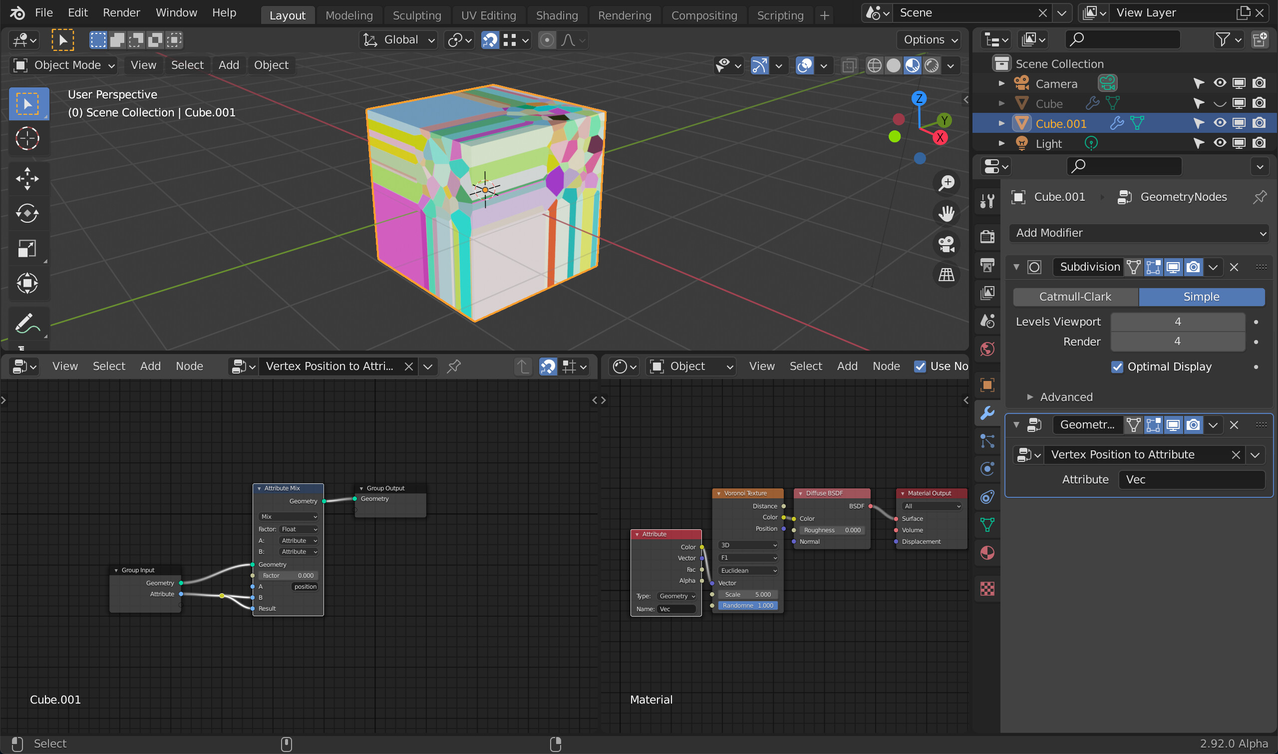

Default Cube without any mapping:
Default cube with mapping setup inside Geometry Nodes:
