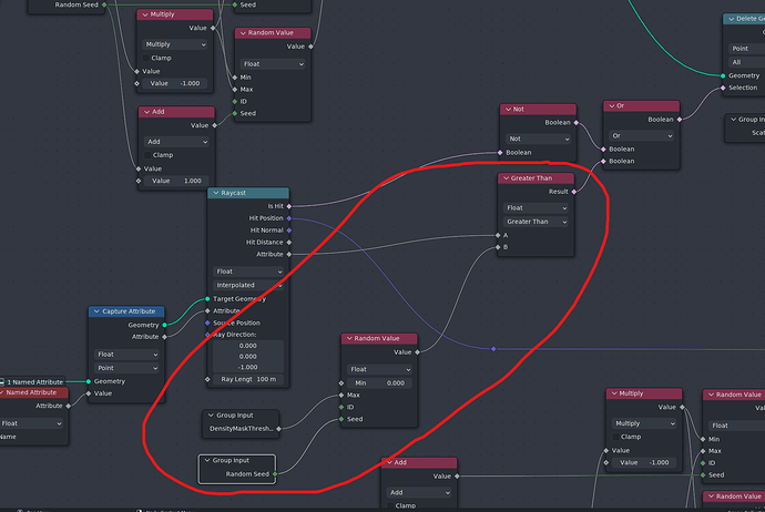

BTW, if you also vary the Density Factor using attribute painting, then Distance Min won’t help you at all, like in this example with the road and vegetation instances:
Why is it an inconvenient workaround? If you want an even distribution its much less inconvenient to start with an even distribution and then vary it a bit than it is to try to force a node meant for scattering into something it wasn’t made for.
If you start with a grid or a mesh line you have perfectly evenly spaced points.
Yes, it looks like I will probably end up by using the grid (in my case the ground mesh vertices) to create the points.
I just need to figure out how give it the functionality of Distribute Points on Faces, specifically how to pair it with a density attribute (so I can paint the distribution) and how to achieve stable IDs, so my collections children aren’t regenerated after each adjustment.
Thanks!
@jendabek Exactly what I was about to say. Start from an even distribution and introduce some chaos instead. You can paint it by simply deleting points that are close to a masked vertex on the ground mesh
Thanks, I managed to get attribute density & stable IDs working using this setup.
