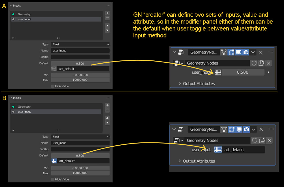

another way could be to let the creator of the node tree to define a pair of value/attribute defaults, so when the user later toggles between the two methods, both of them have a predefined default ā€œinput valueā€, and you don’t link the input name to the attribute’s actual name, which could be limiting or inconvenient.
