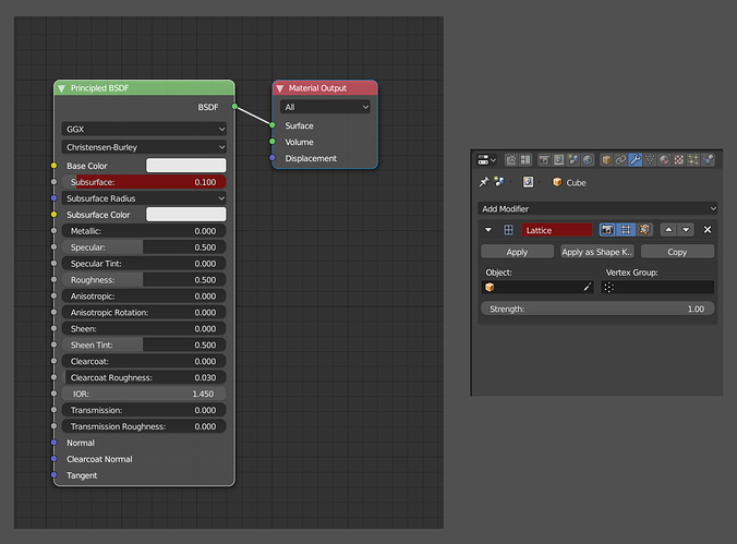

Or maybe as you guys said, a warning at least would be convenient, something similar to when you apply a lattice modifier to something but haven’t picked the lattice that is to affect the geometry.
