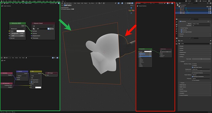

Please try to check these Settings in the image, red is hair (front); Green is the eyebrows (back); Yellow is the render Settings
I guess it’s a problem that ev has always had: the front and back transmission materials can’t be superimposed on each other, otherwise there will be render level errors (this is still a guess), and ev’s solution to this problem is very simple: disable one of the transmission
So here I chose to turn on the transmission for the object in front and turn off the object in back

Aha. I found my error; my shader on the circle/object was incorrect.

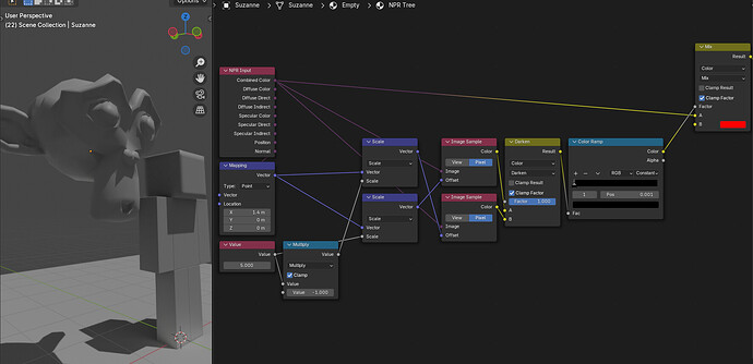

has anyone figured out a way of having a rimlight work on a square shaped character?
i thought of using the image sample node but didnt work out as well…
Like this?
yes, also what are the blend modes used?
It doesn’t seem im not getting the intended result
Try switching the color ramp mode to constant and setting the value to 0.001 to get a clean edge

i did follow your image bit by bit but couldnt reproduce the effect

Managed to get the intended result by switching to diffuse color
Now the trick is trying to render it in front
The current information is not enough to determine the cause of the problem, I tried to re-enter blender and improve the interface: the reason is that the output of the CombinedColor channel contains the result of the shader’s calculation of the light, so I chose the DiffuseColor channel information, after all, in this case only the shape of the object
