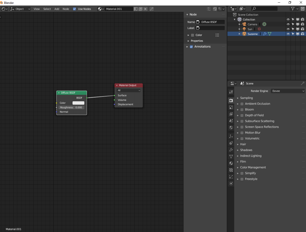

My scene, and Suzanne’s shader:

It’s probably the light intensity that is different. Cycles uses shader nodes for lights, Eevee does not. We plan to unify this still. For now you have to manually ensure they are balanced.
Thank you. Good to know you plan to address this.
