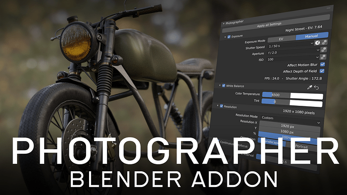

I’ve recently seen three Blender add-ons* that try to deal with getting real world lights into Blender, which all came to the same conclusion, that the sun is per default way to dim, and to counteract their brightening of the sun they all change the exposure by roughly 6 stops.
I wanted to ask if someone more knowledgeable with cycles or color management might comment on this and explain a bit on why these add-ons are doing this and why Cycles / Blender isn’t doing it per default.
The slider value is the stop value, so “roughly 6 stops” means roughly 6 in the slider, as explained in your BA thread
