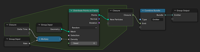

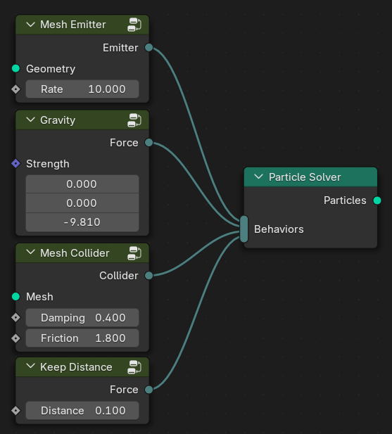

We are working towards various core features (bundles, closures, lists) that together will allow building declarative systems. The image below shows how individual behaviors could be encapsulated by node groups. All behaviors have the same type which allows easily combining them to form higher level behaviors. Also note that the order in which they are passed to the particle solver is largely irrelevant.
This approach to building particle solvers allows someone to focus on building the actual solver that exposes a specific interface while anyone else can just build and combine behaviors for that solver without worrying too much about how it works internally.

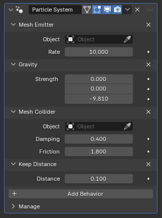

Since all behavior node groups have a very similar structure (various inputs, one behavior output), we can also build a higher level UI for managing them. For example, if the Particle Solver node group is used as modifier, the UI could look like in the following mockup. Note that each panel corresponds to one behavior and that an arbitrary number of behaviors can be added. The individual behaviors would be node group assets coming from an asset library.
Of course one always has more flexibility in the node editor, but this kind of UI should be capable of solving the most common needs without requiring the node editor at all.

Each individual behavior will generally be encapsulated as a bundle. The exact structure of that bundle is determined by the solver that uses the behavior. For example, a very basic mesh particle emitter could look like in the image below. Note that the Type in the bundle will be used by the solver to figure out what kind of behavior this is. The solver will call the Emit callback to actually create the new particles. The inputs and outputs of the callback are also determined by the particle solver.
Closures are a fundamental feature to make this whole system work, while at the same time being a fairly niche feature that most people will not have to know about. Most people will just use systems that heavily rely on closures under the hood to be able to provide a good high level user interface.

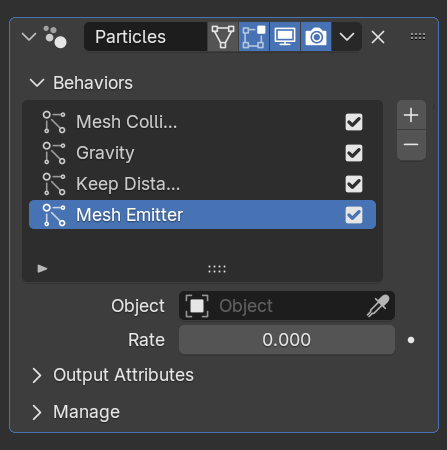

About UI, I was thinking about how to create base primitive modifier for terrain, and give users ability to pass “behaviors” (like curve path for road, mountain peak with empty, etc.) inside modifier, without requiring to open node tree.
Solution I came up with is have “UI List socket” in geometry nodes. Technically how it should work I don’t know, maybe it can be just menu socket that looks little different I don’t know, but what I had in mind is that modifier will have panel “Behaviors” with empty UI list, similar to one of shape keys, with plus button next to it and when clicked it shows list of behaviors that can be used, which are all node groups with some custom tag.
When there are behaviors added user can select one and UI below shows inputs of that node group, again similar to how shape key properties are shown. Just an idea I had that I’m throwing out there, I think it can work very well with particle simulations and other physics. Current method has big issue of bloated UI that looks intimidating, and having features built-in that users just don’t touch. Being able to only add behaviors you want would be very clean and easy workflow.

Yeah, a UI list in the modifier is pretty much the same thing. It was just easier for me to make the mockup with panels. In theory it can even make sense to have some sort of tree view if individual behaviors are extensible too.

I much prefer the panel design with the Add Behavior button to the checkbox list. The checkbox list has visual clutter with things that aren’t being used; the panel list only has the needed information, no more, no less. Especially thinking long-term with terrain; competitor terrain generators have hundreds of “behaviors”. Having all of them in one list would be superfluous at best
