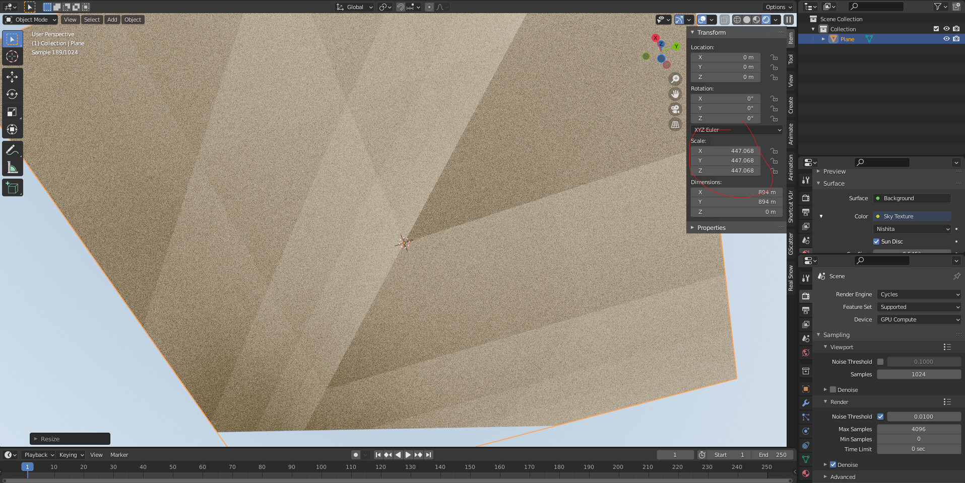

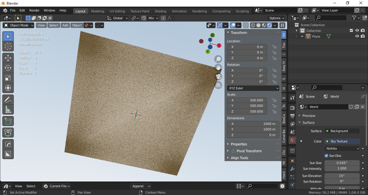

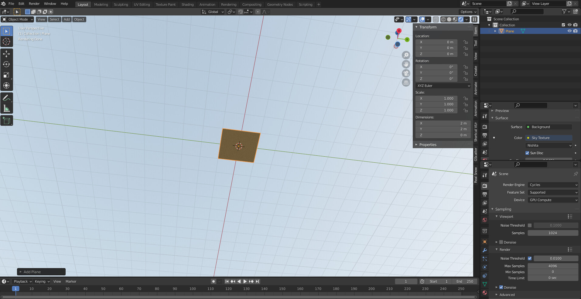

I have found a bug in Cycles x with simply having the sky texture and an upscaled plane. The Normals below look strange. On Optix
Scale 1
Scale2
Scale3
It is OptiX specific bug. If you switch to CUDA it will disappear.
OptiX
CUDA:
