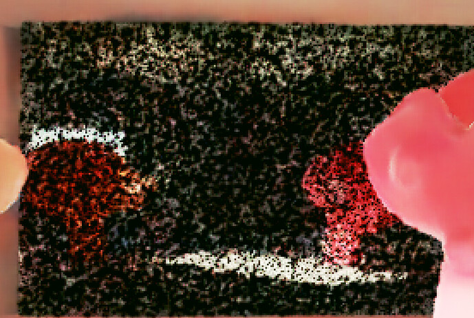

@Eary and @rtdietrich With the recent changes made to the Cycles-X branch of Blender in relation to OIDN, two things were changed.
  1. “CleanAux” is enabled at all times (unless using the compositing node (this may change in the future)).
  2. “Prefiltering” is an option you can change.
“CleanAux” being enabled at all times can mean you get artifacts like the one shown in the image below if your sample count is relatively low. “Prefiltering” can be used to help avoid this issue. But in the case of @rtdietrich where the use of prefiltering on a old processor introduces a lot of extra processing, it might be preferable to render with “CleanAux” off and “Prefiltering” off, ultimalty getting a blurrier render, but avoiding artifacts and long processing time. At the moment you can not adjust the “CleanAux” value without modifying the source code.
This issue was NOT present prior to the recent changes because the code was designed around OIDN V1.3 which did not have a “CleanAux” option.
sorry if this doesn’t make much sense.
I will bring this use case up with someone and see if the “CleanAux” setting can be exposed to the end user.

This is because of what happened in the recent OIDN changes. Two main settings were changed. “Prefiltering” and “CleanAux”. Actually, here’s a thing that will hopefully explain it better.
Prior to the recent commits, Blender would always denoise the scene with these settings:
CleanAux = off
Prefiltering = off
And this is the result you observe here:
With the recent commits, Blender will denoise the scene with these settings:
CleanAux = on
Prefiltering = Defined by the user in the UI
This means with “Prefiltering” off in the new version of Blender, the results WILL be different when compared to the old version. This is because “CleanAux” is on in this new version when it was not in the old version.
As for why the results with “Prefiltering” off look so much noiser compared to old versions of Blender, that’s because the “CleanAux” setting (which is now enabled at all times) introduces issues like these at low sample counts unless “prefiltering” is turned on.
As for why the “CleanAux” setting can’t be adjusted, that’s still up for debate. I’ve done an investigation into how useful it will be to have the “CleanAux” setting available to the user in the user interface and I’ve given the investigation results to the Blender developers, just waiting on their decision on whether or not to expose this setting to the user or make other adjustments.
Hopefully this helps? I’m sorry, I’m trying to keep messages short, and my though process changes a lot while writing them and I don’t know the technical knowledge of everyone here, so some of this may not make sense. Just ask if you want more information, or if you want a more technical explaination.
